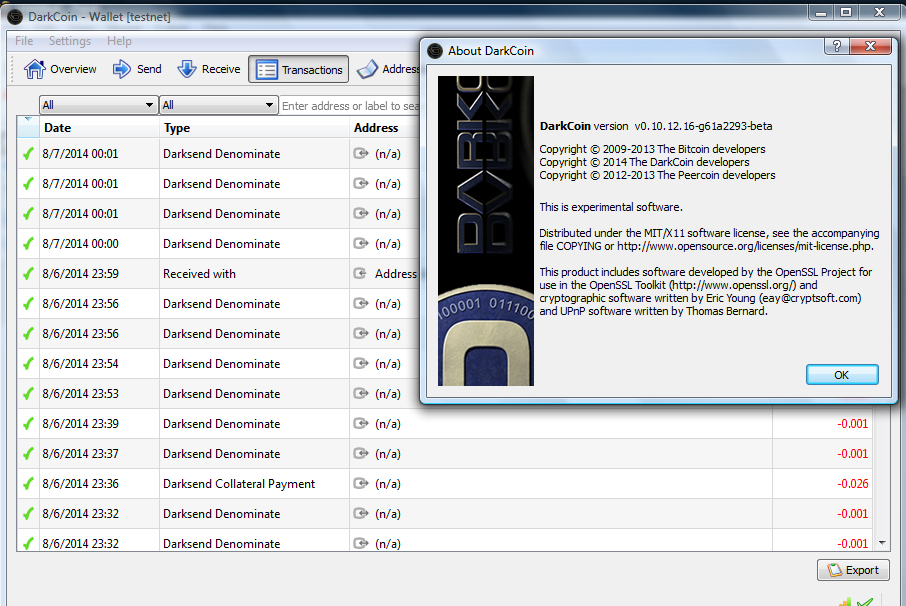

Win wallet (CI-builds for v0.10.12.24-gdf2e08c) from flare. Got 11,000 tdrk from faucet. Not one tdrk got denominated overnight.
Edit: Hm... Just found out I had DS disabled... Not sure how that happened, I disabled DS the last version for the last testing before I deleted the testnet3 folder and started a new wallet with v.24. Going to start over now and see if the denominating will run smoothly.

It took about 30 minutes for DS Denominate to start showing up, and 1499.00000024 DRK got anonymized.

I have set keep anon funds to 800, and i have 2236 anon balance, what about you?
I set the amount of Darkcoins to keep anonymized to 1000. I think it's not a hard limit, is it?
Now I reset the limit to 2000 and restarted the wallet to see if it will anonymize more coins for me. :)
Edit: Now I've just got 2 fees "Payment to yourself -0.002". Not sure what these fees are for.

Correct, that is not a hard limit and is working different than you are expecting:
So to clear up how this setting works. It's more of a lower boundary, whenever your client has more denominated inputs (of any amount of rounds) than that amount it switches into a mode that ONLY uses the denominated inputs. There's a better way to do this and it's on my list, but I figured this solution was better than the 5000DRK limit. It'll get within a few hundred, at most a thousand.

defunctec: just in case you want to know: After I reset "the amount of Darkcoin to keep anonymized" to 2000, the wallet got 10 DS denominates, and 4300 more coins got anonymized, for a total of 5799 anonymized coins now.
