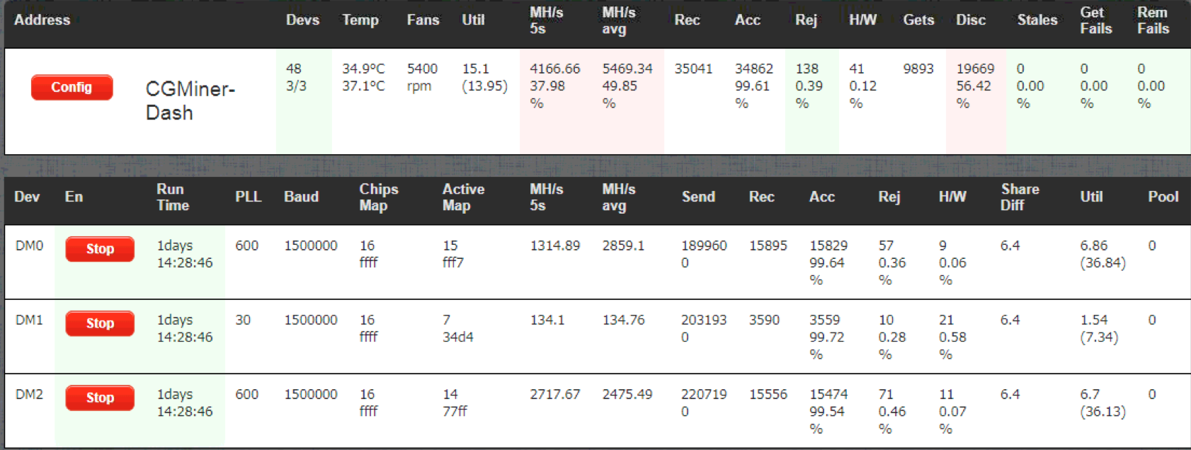

hi , iBeLink ,
please check my mining machine , is tat something wrong? is that actually means one of my board doesnt work ? i only have 3 board working ?
2nd question is look at my mining rate of DM1 is only 134.1mHz , is it normal ?

hi , iBeLink ,
