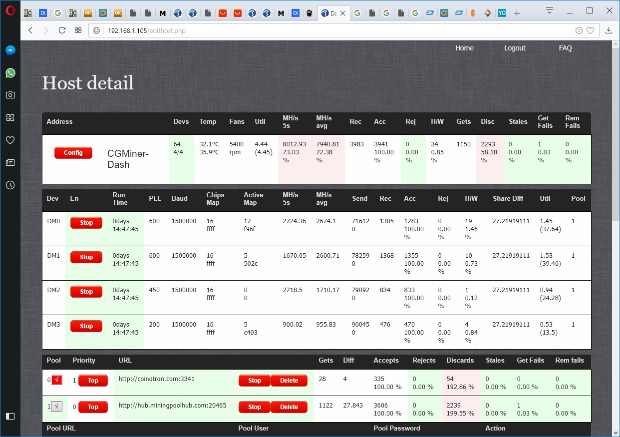

Good day, support!
I have several iBeLink DM11 machines. All of them working properly except one machine. Two boards don't work with full power efficiency and don't realise its' own potential. Here's the screenshot of miner. Look at the PLL column. Two boards are ok, but the remaining two are not. Room temp. is 25 degrees C. iBeLink's temperature is a lil bit hotter than the other machines but anyway I think this temperature shown at the picture is acceptable. I've tried to reboot it many times, update the firmware and restore it - no result. Maybe machine 'thinks' that temperature of blades is too hot and automatically reduces the PLL value. How can I apply fixed PLL value so that it wouldn't change it automatically?
Please, help me to make the best use of my DM11.

Good day, support!
Hi,
Can you also double check the temperature dip switches are set correctly? Each setting is shown on sticker on the top panel board. This will involve removing some screws to take the blades out of the case. If all the settings are correct we can troubleshoot further.

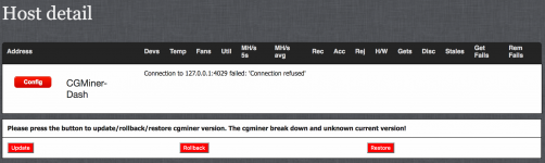

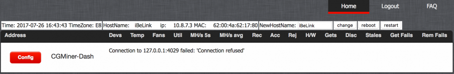

Hi all. Today I connect my new miner to the network and tried to configured it for the mining as usual but when I logged in I got following very unusual screens (below) on home and config paged. SW rollback/restore actions brought no results. What is the verdict here, TF re-image?
Hi,
It does look like the sd card may have gotten corrupt and need a re-image.
