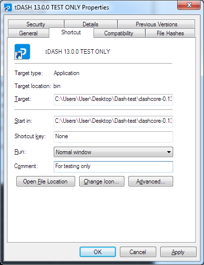

Double click dashcore-0.13.0 and double click bin. Create a short cut to dash-qt.exe. Cut the shortcut and go back (up) two folders to Dash-test and paste it there. So the shortcut is now in the same place as the two dash folders, one from the zip and one that you created.
Edit the shortcut. You only have to change the Target. Make the target look like below, you will have to change User for your username when setting the -datadir.
C:\Users\User\Desktop\Dash-test\dashcore-0.13.0\bin\dash-qt.exe -debug=1 -testnet=1 -datadir=C:\Users\User\Desktop\Dash-test\data
The important things here are the location of -datadir and -testnet=1 flag. We want to make sure this version of Dash stays well away from your mainnet Dash !
Click Apply and OK. If your username has spaces in it, try putting the Dash-test on C:\ otherwise you need to put " around -datadir flag.
At this point if Windows allows you to save the shortcut it means it has no errors and you can double click it to start syncing and testing. Check that it is writing data to the data folder. You can ask in the #testnet channel on discord for some free tDASH.

Ugh, I'm having a hell of a time syncing. This is my 4th attempt, it was stuck at 18 hours forever. I've tried deleting peers.dat this time and reindexed. Is it really slow to sync on testnet? Earlier I saw more than 400 nodes, so I would think not, but???
qwizzie
Aug 6, 2014
2,019
1,199
Try keeping only v.13 nodes in your peers tab (kick the others), then copy a bunch of them that seem reliable (stay connected) and put them as nodes in your dash.conf (addnode=ipaddress).
Lastly delete the peers.dat file and start the wallet again.
You can add these for now :
addnode=140.82.59.51:19999
addnode=66.244.243.87:19999
addnode=145.239.235.17:19999
