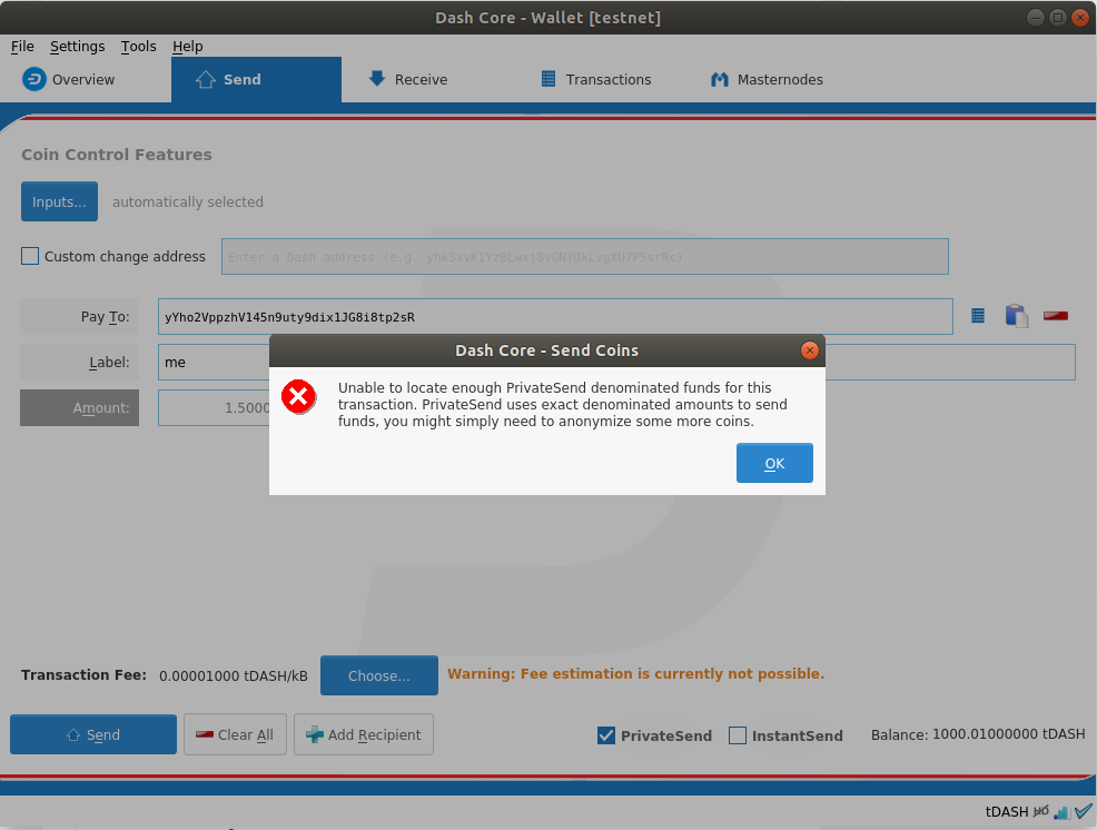

Excuse me, is PrivateSend supposed to work with integer numbers only? When i type anything with lower denomination it throws an error

You should be able to use numbers down to a single duff, breaking a 0.001 for unmixable change...
Hmm... UX seem confusing since it shows a balance, but not a DS balance. From that screenshot, we have no way of knowing if you have a sufficient DS balance... Maybe the error is totally appropriate. There's no way you or I can tell... What's going on?
I came across these sort of errors too, while trying to PrivateSend certain transactions, i dont think it has anything to do with integer numbers.
What i normally do with PrivateSend transactions these days is :
* Mix to at least 9 rounds (provides pretty strong privacy)
* Try to send a PrivateSend transaction, if your mentioned error occurs you then have two options :
1 : Lower your number of rounds with one round (in this case to 8 rounds) and try to send that PrivateSend transaction again ( this seems to work most of the times as it frees up some input amounts and you still have strong privacy)
2 : Do more mixing by setting your number of rounds higher (in this case to 10 rounds), hit the Start mixing button and when done mixing try to send that PrivateSend transaction again
Setting higher or lower number of rounds to mix can be done through Settings --> Wallet --> PrivateSend rounds to use (which can be set all the way to 16).
Personally i prefer to set the number of rounds to mix a bit higher then strictly necessary, so i can just lower the number of rounds if that PrivateSend error pops up and still have strong privacy.
