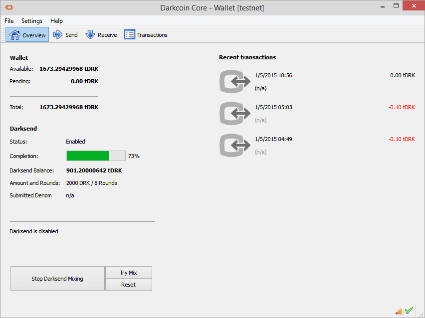

partially fixed.
  • not understanding the part with the progress bar
  • transaction tab you can resize the columns on your own
  • default windows size: create a ticket against bitcoin
  • normal transaction was always normal transaction, not understanding this tooltip
Progress bar example is 75% now, then sudden it jump to say 25%, then after while it jump to 85% and so on...
Normal payment is without darksend enabled, i think darksent payment is not normal.

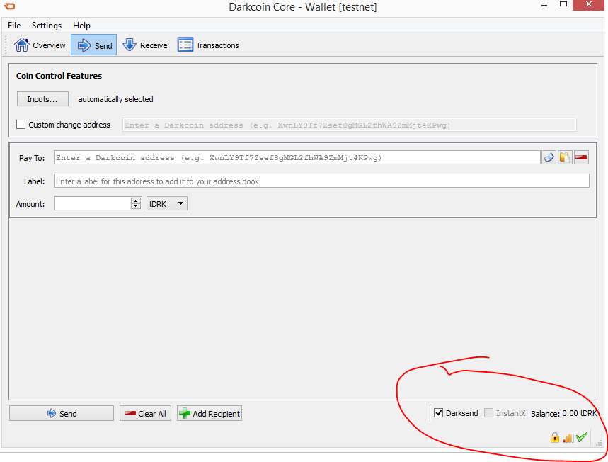

...a wallet where I could not use DS anymore.
I'm not sure a screenshot could tell you more... but if you like.
Could you do me a favor... and just try to make the same steps with your wallet... maybe you could verify my problem:
1) make a fresh wallet with some tDRK in it.
2) mix the coins with DS. I used 1000 / 7 rounds.
3) when mixing is finished send all coins out to a new recieving address within the same wallet. Send the coins without DS.
I had to select the coins through the coin expert feature manually because transaction was rejected otherwise.
4) After a confirmed payment to yourself you should not be able to mix them again - if it works that way like here.
there is just a fresh tDRK block in the my wallet, but darksend don't care about.
I just reproduced what you asked me to do. And yes I could not send the amount to myself right away because the transaction fee needed to be subtracted from the sending amount. Here's my screenshot:
So either you subtract this fee amount from the total amount you want to send, or you can use the Coin Control and it subtracts the fee for you and gives you the total.
I'm not sure what you mean here:
"4) After a confirmed payment to yourself you should not be able to mix them again - if it works that way like here."
Why shouldn't it be able to mix the coins for you again?
I sent all the coins to another address in my wallet, pressed the "Start Darksend Mixing", and now Darksend is mixing the coins again:

hashcow, I just looked at your screenshot and noticed the problem you have was what I had in version 11.0.4, but I haven't seen it in v.11.0.5 that I'm using. Are you using v.11.0.5? and you're not using the old wallet.dat?
I use windows 32bit wallet on a crappy windows computer. When testing a new client version, I would get a fresh wallet to test it, unless we need to test the backwards compatibility also for the final version. Sometimes i delete Darkcoin in the registry also, just to make sure what i see in the current client version that I'm testing.

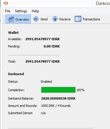

As others have said, establishing a percentage of completion is so difficult because is a dynamic situation, if half way through the process you change the settings or receive more funds or anything like that, the percentage jumps all around and it is very frustrating not to see the 100% and even if it is 98% and you have a nice amount of coins anonymized you still feel the process is not done!
Maybe we just have to stop promising an exact amount of coins that will be anon, eliminate the progress bar, default to 8 plus rounds of mixing and just show:
Darksend: ENABLED/DISABLED
Status: Active/Inactive/In Progress
Darksend Balance: XXXXXXX DRK
And the Darksend Balance grows as more coins reach 8 rounds and you can spend them if you want. The sensation of progress would be to see the balance grow. The upper limit would be around the target amount you set in the configuration, as follows:
Darksend Target Amount: Full Balance / Minimum Balance / A number of your choice between the minimum balance and the full balance.
Minimum balance: would be set by the system and is the minimum Darksend needs to work, so we don't get people trying to anon 0.03DRK and getting frustrated.
So the configuration would be only: enable/disable and the target amount with the options full balance, minimum balance or a number in between. If you try to input a number below the minimum or above the full the system rejects it with a message.
I think the above would be better, and you can keep the status messages that show at the bottom for the user to know that something is happening and the system is OK and working.
Just an idea.

...I sent all the coins to another address in my wallet, pressed the "Start Darksend Mixing", and now Darksend is mixing the coins again
thanks for testing moli. seems to work for you.
this is not the case with my linux wallet.
and it makes me wonder that you don't have to select the coins manually.
I have the same feature as thelonecrouton describes here https://darkcointalk.org/threads/v0-11-0-x-testing.3401/page-25#post-36400.
is there any difference between linux and windows wallet?
I use the latest download linux-64bit v0.11.0.5-88d1e63-beta
edit: yes i'm sure not to use an outdated version.
and it happend me with an old wallet.dat first.
but i could force my "unmixable" wallet problem with my described steps with a clean fresh wallet.dat too.
edit2: I will test the same on some other system too this evening

Updated to 11.0.9 today and then started Darksend Mixing 2DRK over 2 Rounds
So far I have 1.1DRK of Darksend funds but the problems is I also have 21 x -0.0001DRK payments to myself and 3 x -0.0002DRK payments to myself.
I'm only trying to mix 2DRK, the Darksend Mixing has not been restarted and the network has been solid.
I don't understand why I have been punished with so many minus payments... I'll leave it running to see what happens.
EDIT: I've just noticed I also have 11 transaction conflicts.

That looks like there were some incomplete mixing tx.... Can you give me a tx id of one of that incompatible and one of -0.0001 somewhere in the middle please? can I have debug.log also? [email protected]
You can restart your wallet with -zapwallettxes option, that should fix incompatibles.
Sent you an email.
