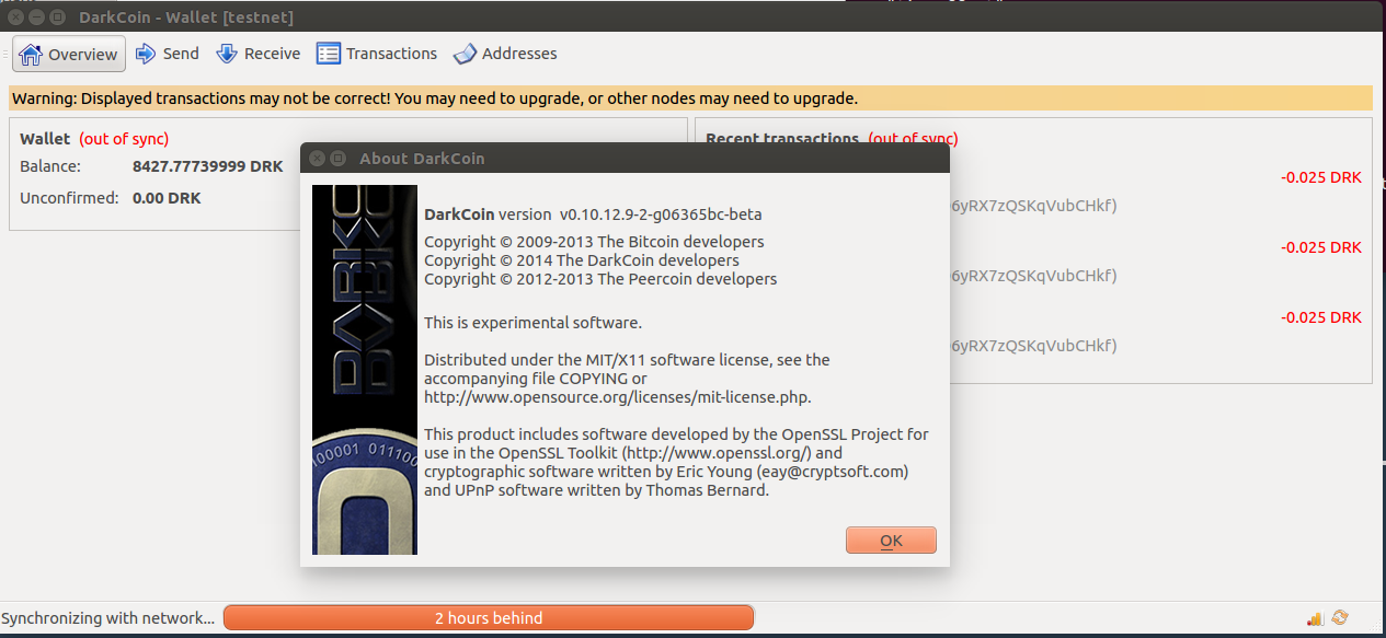

Any Idea what going on. Wallet stops on Block 6731

Ubuntu v12.04.4 64 bit. I thought MangledBlue was referring to my post too. Best to use reply button. :smile:

Re. your crash: Never had problems with Ubuntu 64 - maybe your wallet/blockchain directory is corrupt. Did you already try to delete and restart from scratch? It's hard to track down unreproduceable errors...
