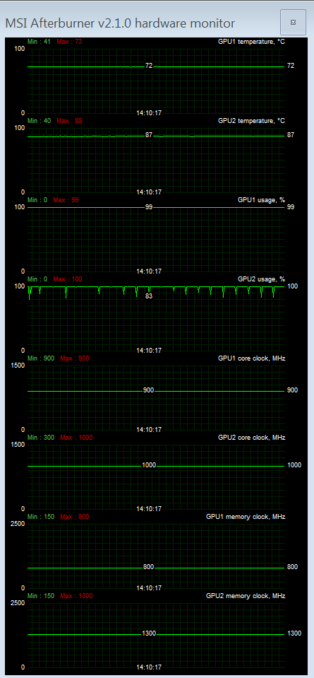

Ok, I wanted to have another go at the config before I posted, the strange thing is on both windows machines the R9's do not allow clock/memory change but the Amd 6950 does.
Here is the config and afterburner ouput results, can you see the amd 6950 clock = 900 and memory = 800 so working ok but the R9 290 is stuck on the factory default of core clock =1000 and memory = 1300.

Hi!
I think you can overclock/underclock in the AfterBurner itself instead of using sgminer .conf.
I usually overclock straight from sgminer .conf file and don't use afterburner.
I also noticed that you have both temp-cutoff and temp-overheat set to the same value. I'd recommend to set temp-overheat to 87 or 90.
PS: Usually miners set gpu-powertune to 20 to maximally increase the mining speed, but I presume you deliberately have it as 0 to keep the system cool.

Cheers for reply, unfortunately the afterburner slider settings are ignored but the charts are accurate, perhaps installing another driver or newer afterburner would do it, (I always use catalyst 14.7 RC3 because it is the quickest and most stable)
All of my cards are AMD sapphire cards, and I use 14.12 AMD catalyst version (seems to work the best not sure why), and I use TRIXX, and have been able to overclock cards on R9 270x, 7970s, 7950s. Just thought I'd throw that out there, it might not work for MSI cards. As a note too, my cards are getting hot, I mean close to 90C, sometimes I just back them off or let everything cool off....
Managed to get the config working thanks, now I have more hardware faults same you!
btw I tried TriXX, like the layout but it has the same problem as afterburner, although it allowed me to access the voltage settings that were previously disabled.
