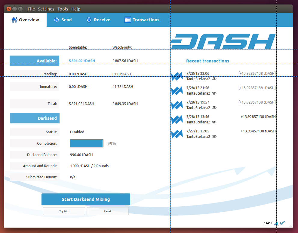

I was just browsing github a little when I saw a screenshot in crowning s PR:
https://github.com/dashpay/dash/pull/459
Maybe it's just me, but I find that the layout looks a bit messy. I've played around in Gimp a little to make items line up a little better:
here are the lines I'm referring to:
It's of course just a minor observation, but maybe if someone feels like changing the css in the near future, I'd like to put this in as my suggestion :-)

the-baker , I don't have that second column "watch only" in my testnet wallet. What is it? It causes a bit of clutter. Lining up headers would be nice and also, if the header font could be slightly larger than the information below them (or to the side) I think it would visually help clump them together?? (particularly "Recent Transactions"
Yep, and maybe recent transactions front icons (arrows) 50% smaller size.
The image is from crowning's pull request, which isn't merged yet. So if you are on a regular branch build, you don't have it yet
I've implemented your suggestions (which are good BTW), however I have to wait until Evan merges my current PR because I've messed-up my local repository and want to start with a clean "git clone".
I always wondered what the "try mix" and "reset" buttons are for. If the big "Start/stop darksend mixing" button is sufficient (i never used anything else) it might be a good idea to remove the two buttons or migrate these to the top menu, to get a cleaner and simpler UI.

hmm... I barely ever use them anymore either.
crowning I hope the watch-only column is not going to be part of the release? The Overview screen should be kept as clean as possible. If the user wished more info, they should be able to find it elsewhere.
I suggested in Jira that even the Darksend progress in the overview screen is too much. I think that we should eventually create a new "Darksend tab", which would house this information, moving it from the Overview screen.
The other cool thing I suggested was to have the functionality to use the Darksend tab to send Darksend transactions, and keep the Send tab just for normal transactions. InstantX could be a checkbox in both tabs.
I really hope that can be accomplished one day, as I feel that would improve the UI dramatically, and showcase one of our flagship technologies. Would it be hard to do?
