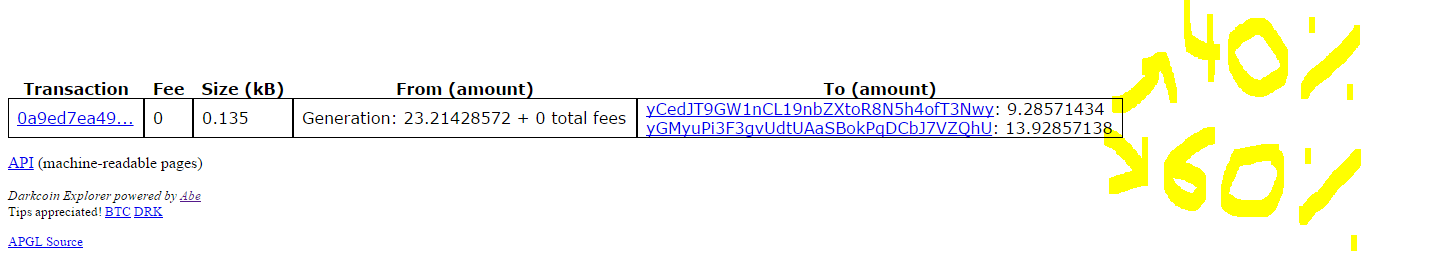

Currently we are seeing
Normal block
40% miner reward
60% masternode reward
Or if we account 10% as "escrowed budget"
36% miner reward
54% masternode reward
e.g. http://test.explorer.darkcoin.qa/bl...c45d18d27ee7d7185dbcef068450bc11fb1ebb4f5181c

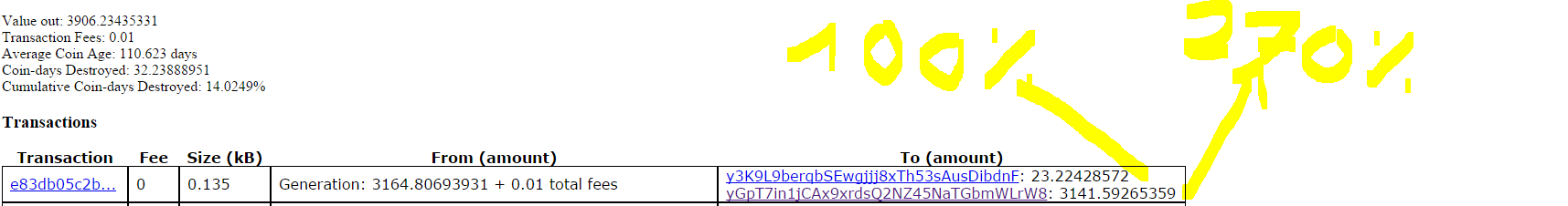

Superblock (each 50 blocks)
http://test.explorer.darkcoin.qa/bl...ce7979abbd0dbfcf87e846a55aebd3c1df40e4f23c545
100% miner reward
270% bugdet payout
which is broken: Where is the masternode reward in this block? Why have 49x 23.2 + 3164 = 4300 tDASH been mined in the last 50 blocks, when it should have been 50x 23.2 = 1160 tDASH?
Normal block
40% miner reward
36% miner reward
100% miner reward
270% bugdet payout
which is broken: Where is the masternode reward in this block? Why have 49x 23.2 + 3164 = 4300 tDASH been mined in 50 blocks, when it should have been 50x 23.2 = 1160 tDASH?

40/60 - historical testnet rule: https://github.com/dashpay/dash/blob/v0.12.0.x/src/main.cpp#L1582
4300 vs 1160 - because it check against real month instead of faked one, I agree math there https://github.com/dashpay/dash/blob/v0.12.0.x/src/masternode-budget.cpp#L736 could be linked to https://github.com/dashpay/dash/blob/v0.12.0.x/src/masternode-budget.cpp#L25 instead - make a PR :wink:

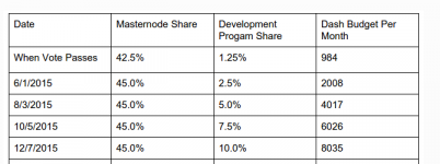

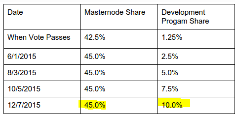

There will be no inflationary effect on mainnet, when there's 1 set of superblocks per month totally 8000 DASH or less. The effect on the coin generation will actually be deflationary. These superblocks are allowed to happen 10 times a day right now, however on mainnet they will be once per month.
There's an average of 553 blocks per day on mainnet (60*24/2.6), which means we have 16615 blocks per month. To not be inflationary, we'll reduce the block reward by 10% each block . Total monthly generation can be calculated as 553*30*5*.93 = 77143 (minimum), so 10% of that is 7714 (minimum). That means every 16615 blocks on mainnet, we'll be allowed to create a few blocks that total that much in generation. We'll eliminate 10% of the total reward, but we'll only be allowed to create the minimum reward. For example, if we average 8DASH per block and reduce the block reward by 10k DASH, we'll still only recreate up to 8k DASH. If we only have budgets approved for 3k, that will result in the other 7k DASH never being created at all, a deflationary effect.
But why does the budget logic have to influence the coin supply at all? Couldn't the the difference (the 7k in your example) be distributed as mining reward for all following blocks until the next superblock is created?
