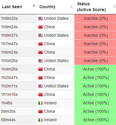

Masternodes still getting inactive after 60 minutes, even with v0.10.16.11.
A script automatically starts them again once they are down, but it's still annoying.
This is how my log looks like for the last 30 hours or so, the big dip in the middle was the update to v0.10.16.11 last night:
Can't reproduce this as per now - my nodes are active since 12hrs now, no drop since "remote dseep update"
How do you check them for being inactive?
I have a darkcoind running 24/7 which checks the output of "masternode list", "masternode count", "masternode winners" and whatnot and does, besides logging all that stuff, restart the Masternodes with "masternode start "<passphrase>" for those which are down.
Works like a charm, but shouldn't be necessary at all.
And yes, the results of my logging darkcoind match with elbereth's site and the log of the Masternodes itself.
Edit: the log above displays 5 minute intervals, so when a node went down in between it might be already restarted before it gets displayed in that graph.
Well, if this darkcoind updated to 16.11 too then I have no suggestions so far...

My script looks for both. When "masternode list" reports a Masternode as inactive (=0) or when it doesn't show up at all it gets restarted. No anticipation...
Maybe your criteria "=0" is a bit to harsh to restart on immediately...

that's weird...
what's your output for this:
cat ~/.darkcoin/debug.log | grep "CActiveMasternode::RegisterAsMasterNode()" | tail -n 20
You should have a lot of "....Is capable masternode!" too which is again weird...

I'm getting somethign different from flare....
2014-11-16 10:22:55 CActiveMasternode::RegisterAsMasterNode() - Masternode input = CTxIn(COutPoint(2874256e548dd285f58b50e01dd2ae5de31f064edab0c14b749de62f64701f1d, 1), scriptSig=)
2014-11-16 10:42:55 CActiveMasternode::RegisterAsMasterNode() - Masternode input = CTxIn(COutPoint(2874256e548dd285f58b50e01dd2ae5de31f064edab0c14b749de62f64701f1d, 1), scriptSig=)
2014-11-16 11:02:55 CActiveMasternode::RegisterAsMasterNode() - Masternode input = CTxIn(COutPoint(2874256e548dd285f58b50e01dd2ae5de31f064edab0c14b749de62f64701f1d, 1), scriptSig=)
2014-11-16 11:22:55 CActiveMasternode::RegisterAsMasterNode() - Masternode input = CTxIn(COutPoint(2874256e548dd285f58b50e01dd2ae5de31f064edab0c14b749de62f64701f1d, 1), scriptSig=)
2014-11-16 11:42:55 CActiveMasternode::RegisterAsMasterNode() - Masternode input = CTxIn(COutPoint(2874256e548dd285f58b50e01dd2ae5de31f064edab0c14b749de62f64701f1d, 1), scriptSig=)
2014-11-16 12:02:56 CActiveMasternode::RegisterAsMasterNode() - Masternode input = CTxIn(COutPoint(2874256e548dd285f58b50e01dd2ae5de31f064edab0c14b749de62f64701f1d, 1), scriptSig=)
2014-11-16 12:22:56 CActiveMasternode::RegisterAsMasterNode() - Masternode input = CTxIn(COutPoint(2874256e548dd285f58b50e01dd2ae5de31f064edab0c14b749de62f64701f1d, 1), scriptSig=)
2014-11-16 12:42:56 CActiveMasternode::RegisterAsMasterNode() - Masternode input = CTxIn(COutPoint(2874256e548dd285f58b50e01dd2ae5de31f064edab0c14b749de62f64701f1d, 1), scriptSig=)
2014-11-16 13:02:56 CActiveMasternode::RegisterAsMasterNode() - Masternode input = CTxIn(COutPoint(2874256e548dd285f58b50e01dd2ae5de31f064edab0c14b749de62f64701f1d, 1), scriptSig=)
2014-11-16 13:22:57 CActiveMasternode::RegisterAsMasterNode() - Masternode input = CTxIn(COutPoint(2874256e548dd285f58b50e01dd2ae5de31f064edab0c14b749de62f64701f1d, 1), scriptSig=)
2014-11-16 13:42:57 CActiveMasternode::RegisterAsMasterNode() - Masternode input = CTxIn(COutPoint(2874256e548dd285f58b50e01dd2ae5de31f064edab0c14b749de62f64701f1d, 1), scriptSig=)
2014-11-16 14:02:57 CActiveMasternode::RegisterAsMasterNode() - Masternode input = CTxIn(COutPoint(2874256e548dd285f58b50e01dd2ae5de31f064edab0c14b749de62f64701f1d, 1), scriptSig=)
2014-11-16 14:22:57 CActiveMasternode::RegisterAsMasterNode() - Masternode input = CTxIn(COutPoint(2874256e548dd285f58b50e01dd2ae5de31f064edab0c14b749de62f64701f1d, 1), scriptSig=)
Is that normal?
Yes, that is how it should look like
https://github.com/darkcoin/darkcoin/blob/master/src/activemasternode.cpp#L158
That's the log output right before sending dseep

that's weird...
[email protected]:~$ cat .darkcoin/debug.log | grep "CActiveMasternode" | tail -n 20
2014-11-16 08:13:16 CActiveMasternode::RegisterAsMasterNode() - Checking inbound connection to '54.171.75.34:9999'
2014-11-16 08:33:16 CActiveMasternode::RegisterAsMasterNode() - Checking inbound connection to '54.171.75.34:9999'
2014-11-16 08:53:16 CActiveMasternode::RegisterAsMasterNode() - Checking inbound connection to '54.171.75.34:9999'
2014-11-16 09:13:17 CActiveMasternode::RegisterAsMasterNode() - Checking inbound connection to '54.171.75.34:9999'
2014-11-16 09:33:17 CActiveMasternode::RegisterAsMasterNode() - Checking inbound connection to '54.171.75.34:9999'
2014-11-16 09:53:18 CActiveMasternode::RegisterAsMasterNode() - Checking inbound connection to '54.171.75.34:9999'
2014-11-16 10:13:18 CActiveMasternode::RegisterAsMasterNode() - Checking inbound connection to '54.171.75.34:9999'
2014-11-16 10:33:18 CActiveMasternode::RegisterAsMasterNode() - Checking inbound connection to '54.171.75.34:9999'
2014-11-16 10:53:18 CActiveMasternode::RegisterAsMasterNode() - Checking inbound connection to '54.171.75.34:9999'
2014-11-16 11:13:18 CActiveMasternode::RegisterAsMasterNode() - Checking inbound connection to '54.171.75.34:9999'
2014-11-16 11:33:19 CActiveMasternode::RegisterAsMasterNode() - Checking inbound connection to '54.171.75.34:9999'
2014-11-16 11:53:19 CActiveMasternode::RegisterAsMasterNode() - Checking inbound connection to '54.171.75.34:9999'
2014-11-16 12:13:19 CActiveMasternode::RegisterAsMasterNode() - Checking inbound connection to '54.171.75.34:9999'
2014-11-16 12:33:19 CActiveMasternode::RegisterAsMasterNode() - Checking inbound connection to '54.171.75.34:9999'
2014-11-16 12:53:19 CActiveMasternode::RegisterAsMasterNode() - Checking inbound connection to '54.171.75.34:9999'
2014-11-16 13:13:19 CActiveMasternode::RegisterAsMasterNode() - Checking inbound connection to '54.171.75.34:9999'
2014-11-16 13:33:19 CActiveMasternode::RegisterAsMasterNode() - Checking inbound connection to '54.171.75.34:9999'
2014-11-16 13:53:20 CActiveMasternode::RegisterAsMasterNode() - Checking inbound connection to '54.171.75.34:9999'
2014-11-16 14:13:20 CActiveMasternode::RegisterAsMasterNode() - Checking inbound connection to '54.171.75.34:9999'
2014-11-16 14:33:20 CActiveMasternode::RegisterAsMasterNode() - Checking inbound connection to '54.171.75.34:9999'
[email protected]:~$ darkcoind getinfo
    "version" : 101611,
    "protocolversion" : 70046,
    "walletversion" : 60001,
    "balance" : 0.00000000,
    "darksend_balance" : 0.00000000,
    "blocks" : 170658,
    "timeoffset" : 0,
    "connections" : 16,
    "proxy" : "",
    "difficulty" : 5451.68359964,
    "testnet" : false,
    "keypoololdest" : 1415948843,
    "keypoolsize" : 1001,
    "paytxfee" : 0.00000000,
    "mininput" : 0.00001000,
    "errors" : ""
That's odd, you can't leave CActiveMasternode::RegisterAsMasterNode() without having more log printed...
jiggytom
Nov 14, 2014
104

Yup, see that. I used the binaries..shouldn't be a difference but may it's worth a try on one of the nodes? Have you tried stopping/starting after removing peers.dat on both local/remote?
flare
Administrator
Dash Core Team
Moderator
May 18, 2014
2,286
2,404
Germany
I can't count how many restarts my nodes had the last 24hrs ^^
I like i wrote: i have no issues at all, nodes are active and getting paid since update.
    "version" : 101611,
    "blocks" : 170658,
    "timeoffset" : 0,
    "connections" : 16,
    "proxy" : "",
    "testnet" : false,
    "errors" : ""
Hmmmm.....
How about this?
cat ~/.darkcoin/debug.log | grep "CDarkSendPool::GetMasterNodeVin" | tail
jiggytom
Nov 14, 2014
104
22
68
I had my local wallet open the whole time, I just closed it and will see if that changes anything.
