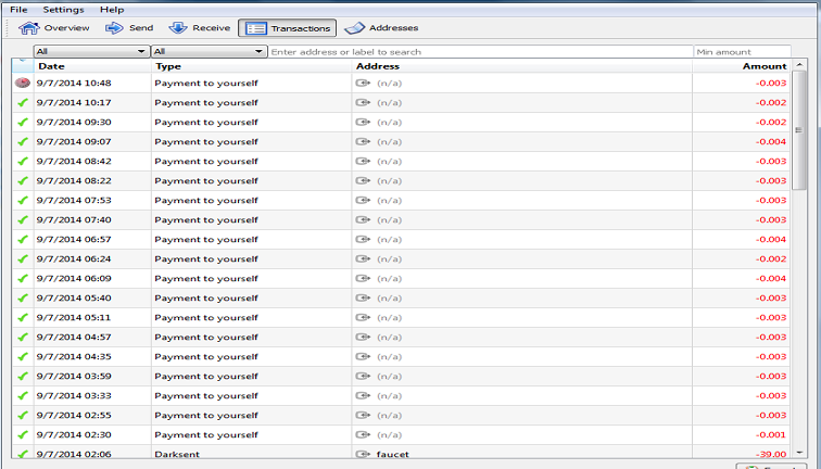

My wallet is getting hit with a lot of "Payment to yourself" fees. After Darksending 39 tdrk, the wallet had 0 anon tdrk left. I had Options setting at 100 drk with 6 rounds... Overnight the wallet seemed to stall, this morning I reset the Options to 50 and 4 rounds... Got hit more with "PTY" fees...
And this is what the Coin Control looks right now:
Isn't the money supposed to be split into 10 drk amounts by now for the anonymizing to happen?

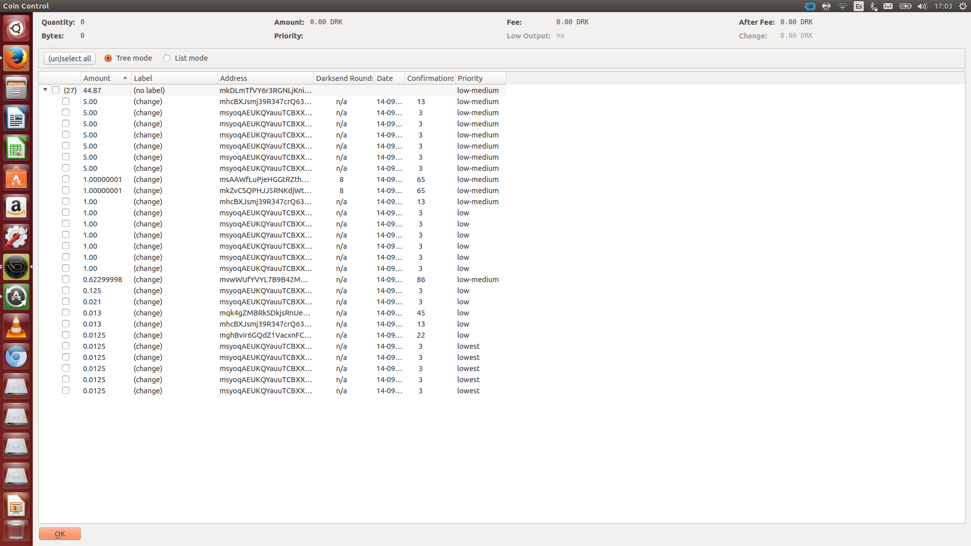

New wallet, 1000 tDRK, settings: rounds 4 and min anon amount: 5.
DS was idle, sent 100 tDRK non anon funds.
After few minutes coin controls shows over 300, 5 and 1 tDRK denom items, i think 5 x 1 should be right.

Good morning. I just woke up. I just set my wallet to the same setting, so far it's at 50% completion, but no splitting into 10 drk amounts. Has your wallet got 50 coins anonymized yet?
At 77%, 78 coins anon bal. I have a few 10 and 1 denominations still in round 2, the rest round 4.

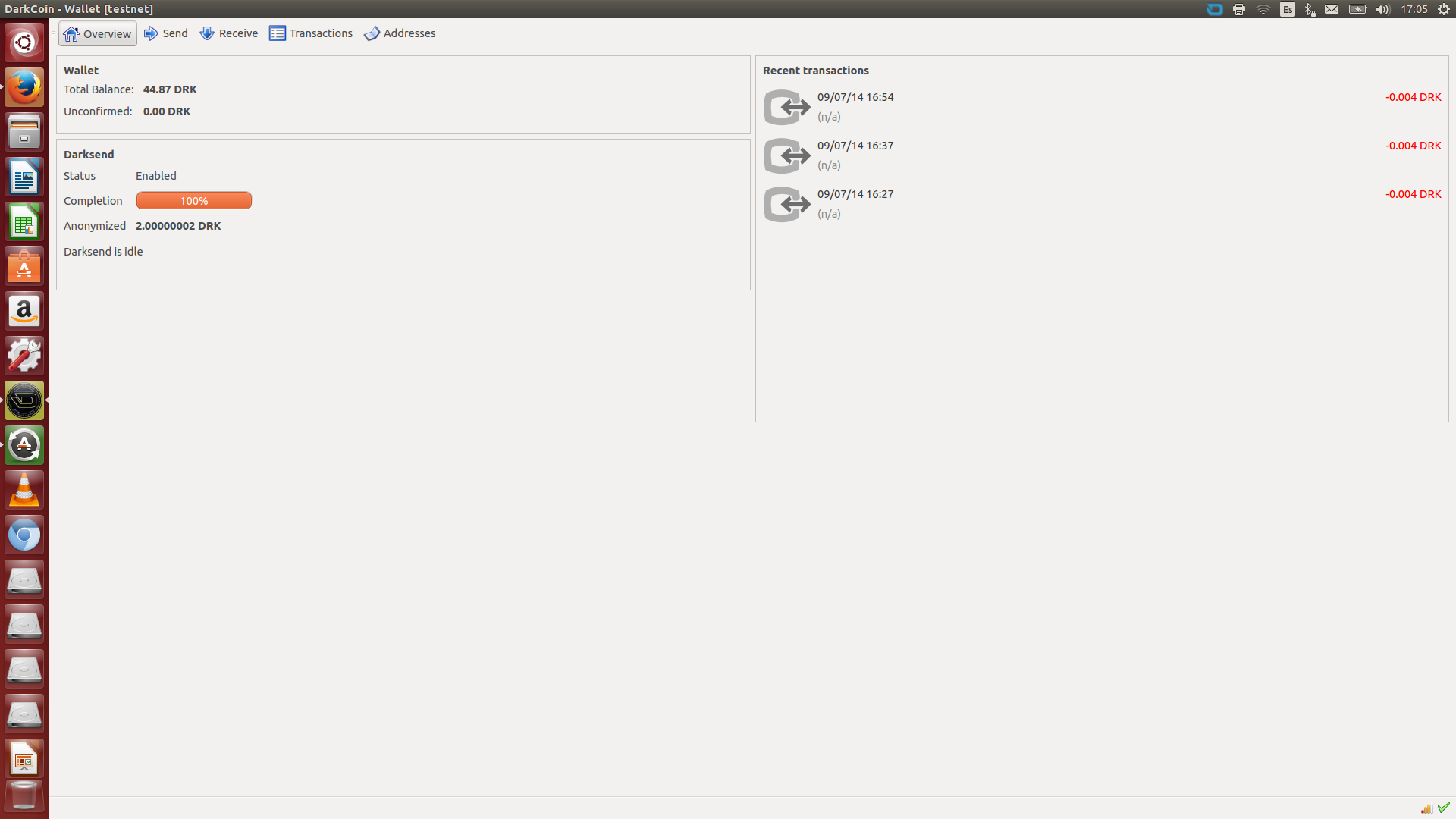

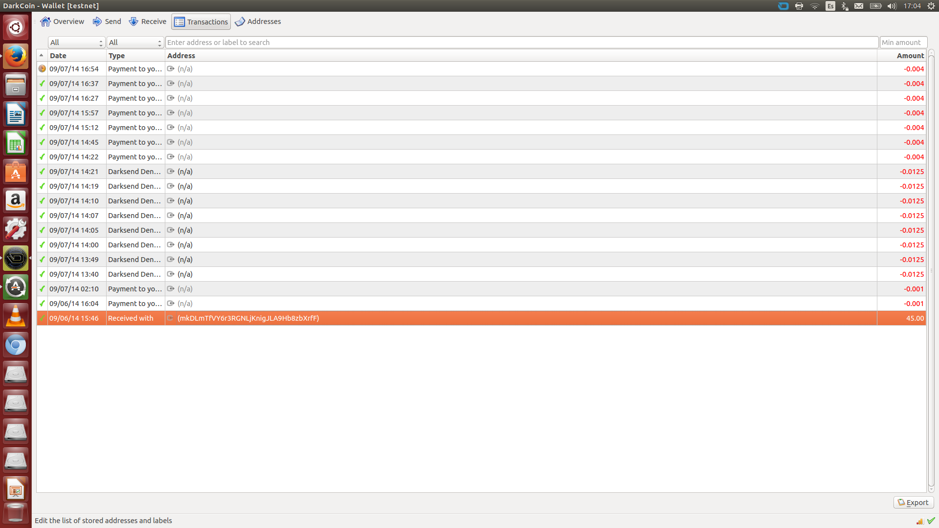

OK I may have an issue but I am not sure. Created new wallet, sent 45tDRK to it, set Darksend to 8 rounds, amount to keep anonymized 5tDRK. The process took long I guess to get the right entries, but it did try. Finally, the system was able to anonymize 2tDRK and showed 100% in the overview, but now I keep getting payments to myself of 0.004tDRK. Why is it still doing this? I would like to understand if this is an issue or not before I post it to Jira, anyone care to explain?
Here is the overview:
Here you can see the transactions:
Finally, this is coin control:
I've had a similar case. I'm thinking of submitting it to JIRA also. Your pictures are quite large, if you can resize them, they would be better looking.
