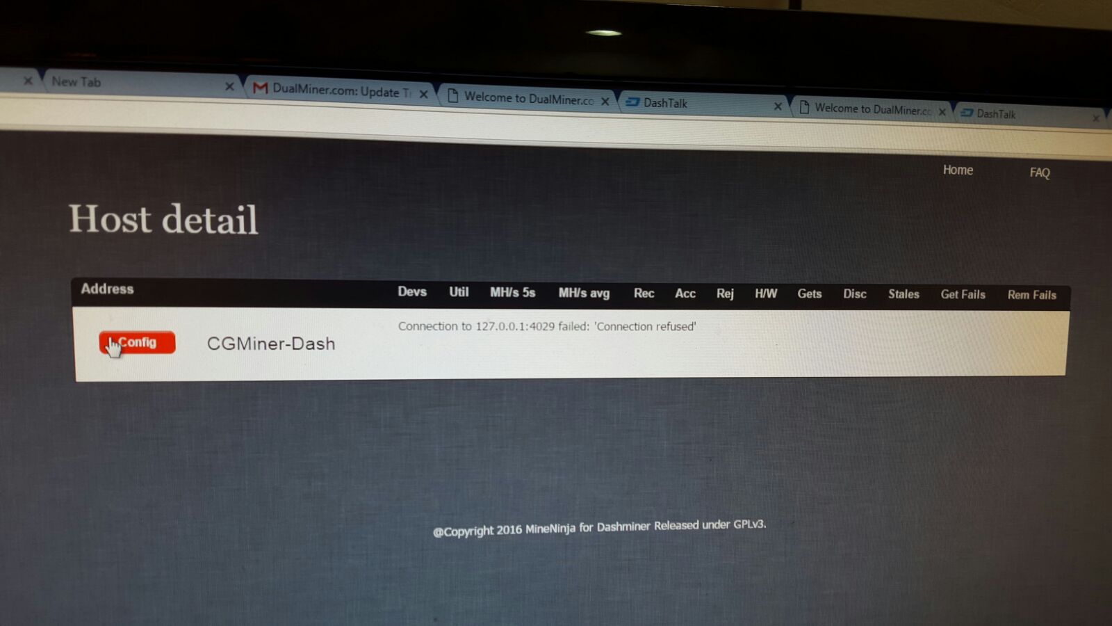

I was able to configure the iBeLink DM384M Dash Miner and i did the update. After six hours of mining the miner becomes unable to configure and i did all troubleshooting but still no change.
Does anybody had faced something like this or what is might be the solution for that problem.
Here's a screenshot of the miner page.
Thanks.

Hi iBeLink team
Thanks.
Dear Ahmed Nattiel:
it seem the miner do not work up after you update, if possible, We would like to remote access your local network to help your configuration.

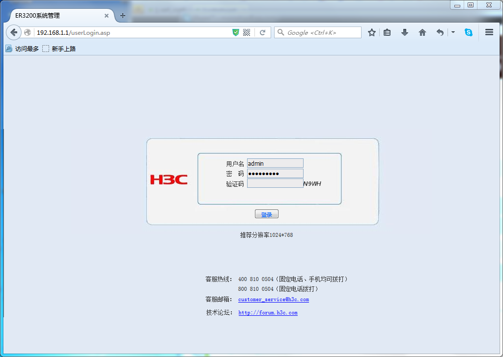

Dear DarkWater:
If your router do not support local DNS service, you should access the miner by IP, and you can find the IP of miner by login the router moniter web(shown pic), and you should confirm your PC is at the same router, and if you have more than 2 iBeLink boxes, please change the host name to avoid the same host name conflict(Default always is iBeLink).
