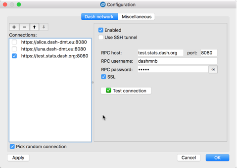

From my perspective you can safely use the provided JSON-RPC nodes, or if you don't trust me enough (I'm quite new to the Dash community) you can turn-off my two nodes (alice.dash-dmt.eu, luna.dash-dmt.eu) in DMT config and use chaeplin's node, which is very well known and trusted community member without any doubts. His node is: test.status.dash.org
Configuration should then look like:
@Acedian I agree with @Bertrand256 - default config should be safe for most cases... but if I still prefer to have things under my own control, especially if that is super easy to do (I already run a node, so all I had to do was reindex with all indexes on). :)

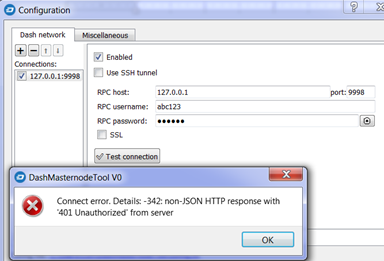

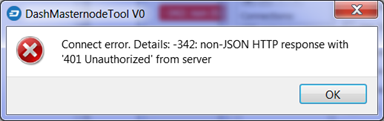

I was able to use version 0.9.3 successfully for Masternode setup. However, I am unable to connect using version 0.9.6.
I followed your instructions closely and even re-installed v0.12.1.5 of Dash Core. Any ideas on what I might be doing wrong and how I can get v0.9.6 working? I'd like to take advantage of the new features!
@Winston84 This error should occur only if your 'RPC user', 'RPC password' GUI parameters don't match 'rpcuser', 'rpcpassword' from your dash.conf file.
Did you open the dash.conf file by executing Dash Core menu: Tools->Open Wallet Configuration File? This should guarantee openning the correct dash.conf file.
View attachment 4211View attachment 4213

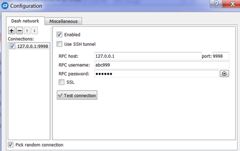

Thanks for the response @Bertrand256. I did access the dash.conf file through the Dash Core menu as you stated above.
I tried both the 64 bit and 32 bit downloads of Version 0.9.6 and neither work for me. However Version 0.9.3 connects without any problem.
I decided to check the other versions as well. I can connect to 0.9.4 but get the same error with 0.9.5.
Any other thoughts on why this might not be working for me? I'm using Windows 7.
@Winston84 It seems that the application in your system actually has some problem with passing connection parameters. To track the problem I will prepare a special version with more logging, and then will contact you with PM.
We are probably in quite different time zones, so the solution may take some time, but I'm determined to find the cause.
