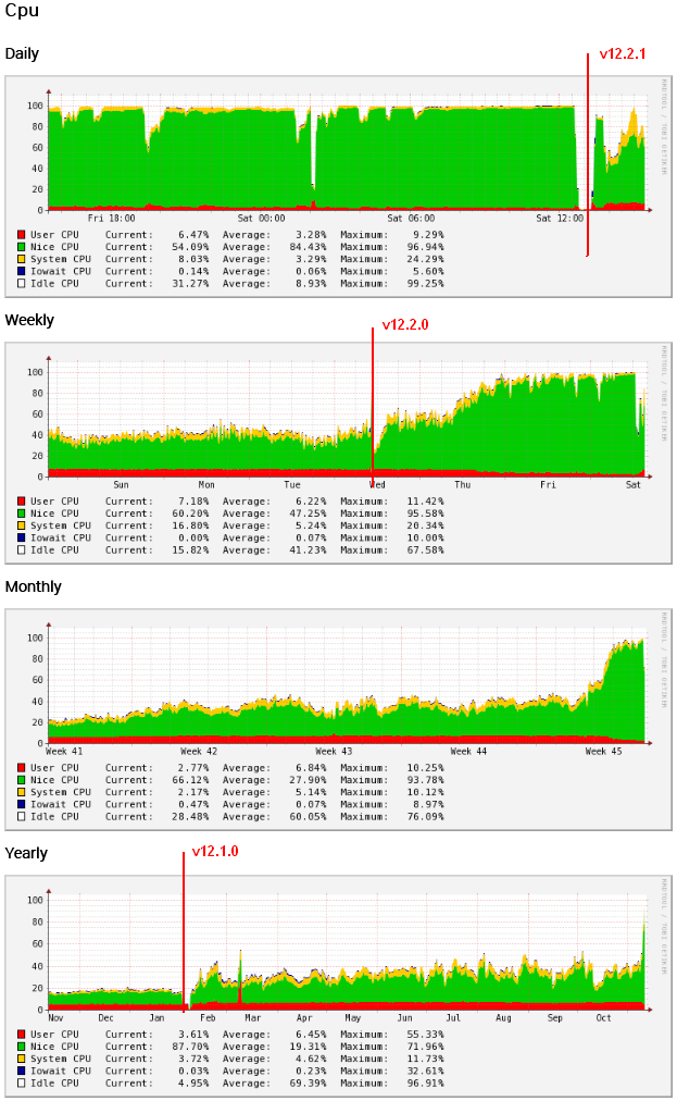

Don't remember exactly and don't have access right now, but it's ESXi with something like i7 4770.
For Dash VM - 1 core and 1Gb RAM.
Ok, but its more powerful than my 1 x 2.4 Ghz core and 1 Gb ram nodes.
My all nodes uses all the memory + some swap and 80% cpu at this moment,
wondering should i upgrade my nodes or wait if devs can tweak dashd more...

I would advice you to upgrade to at least a dual core server, I know it cost a bit more, but it's allot cheaper than missing a payment. At any-rate running 100% CPU power especially on a single core CPU, will most-likely result in your system failing one way or the other. In fact CPU usage around 70%, is much better upper limit to have. I only speak out of my experience as professional and overclocking as a hobby, both from what I have seen and heard. Take it or leave it either way you don't even have to spend 1% of your total profits of running a MN on a dual core or better.
Memory should never be full either, because once it's full you'll have to go the SSD for extra memory, rough estimate would be that is 10x slower.
But any rate I gladly take your spot in line to receive the next masternode payment first (joke)
Yes, i also have 25 years experience in the computer field + building and overclocking.
I agree what you said, but so far my nodes do not have any problems and i hope @UdjinM6 and
the team will tweak software little more efficient if possible, if not then i can upgrade my nodes.

Agree with both of you :) (though dual core cpu is probably still an overkill today). High CPU usage was a combination of a bug and a super extreme load due to migration process, there shouldn't be such issue during normal operation time.
What about high network traffic and connection count? I noticed an increase from usually ~18 connections to ~100 per node to dashd resulting in ~3.6 Mb/s. Traffic is also coming from weird hosts such as web and mailservers. Another DDoS wave?
Lot's of nodes come up and down during migration and they have to sync additional data (mnlist, winners, governance) from scratch first time after upgrade due to changes in cache data structure, so I guess this is also a temporary issue and should go away eventually. We'll see :) Traffic from web and mail servers could be because people use same servers for their masternodes, not sure about that though, never checked.

Devs in my pinion U should correct last DASH. version, because ... CPU is still overheated : CPU is hot 50% about 40connections to other node... Im trying to test with other cryptocurency with results:
CPU Deamon usage fo currencies:
PIVX 3% (30nodes)
DECRED 1% (42nodes)
IOTA 26% (9nodes)
DASH 50% (40nodes)
MONERO 4% (13nodes)
Last time v. DASH have 6% cpu core usage
PIVX 3% (30nodes)
DECRED 1% (42nodes)
IOTA 26% (9nodes)
DASH 50% (40nodes)
MONERO 4% (13nodes)
1 : you can put a limit on the number of connections in your dash.conf (maxconnections=XX)
2 : because of a restructure with v0.12.2.0 and a overlooked bug, a lot of pressure was set on the CPU side.
v0.12.2.1 fixes the bug part.
Try to do another check on your CPU after you upgraded to v0.12.2.1 and after you limited your connections to 10 (maxconnections=10)
How fast is your CPU by the way ? And what kind of processor do you have ?
I checked my maxconnections, and it was 128, so i changed that to 32, lets see how it affects to my mnodes cpu usage.
@UdjinM6 @qwizzie
Maxconnections reduction results from 128 ==> 32, nice drop from 80% cpu usage to 45%.
Also memory usage dropped about 150 MB.
EDIT: Server specs: 1x 2.4 Ghz CPU, 1 GB Memory + 512 MB Swap.
