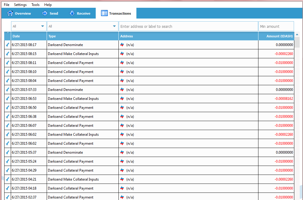

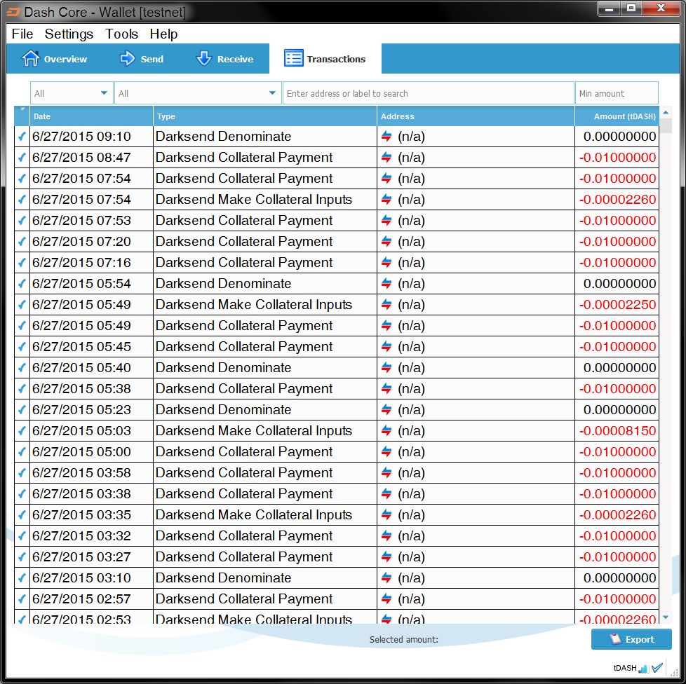

Holy doodle:
bertlebbert - Same thing with my 3 wallets, they all got a lot of Collateral fees over night before I shut them down this morning, here's one of them:

+ "locking inputs" issue which is not in your list for some reason but might be the reason for too many collaterals and DS slowness
