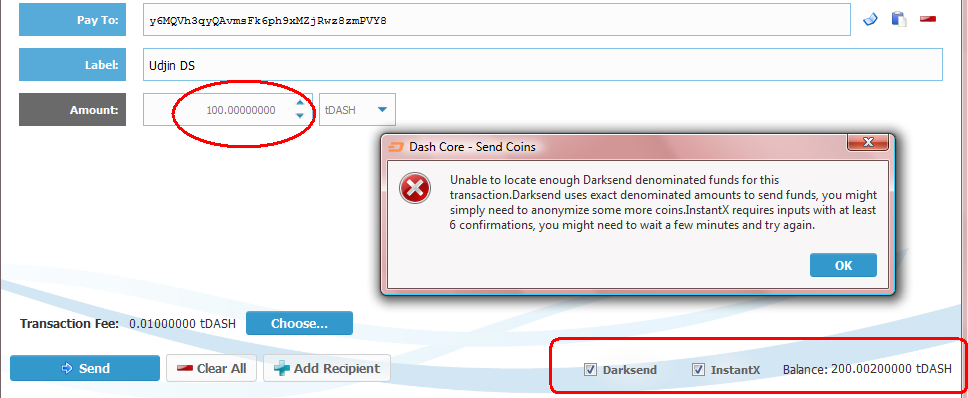

ok, I have a suggestion for displaying "Amount and rounds" (note text itself and its tooltip)
Not enough inputs:
Does it look good?
Testing v.12.0.6
Not enough input: tip box needs to be much wider, check pic.
Also bottom right unit selection does not affect/change Amount & Rounds: dash units)

Testing v.12.0.6
That's weird (tooltip width), I have it just like it is on a screenshot there https://github.com/dashpay/dash/pull/387
What OS are you on?
Yep, switching units will not affect it right away, we will need to completely change the way it's notified/updated - that's the same issue as updating values there after settings are changed.
