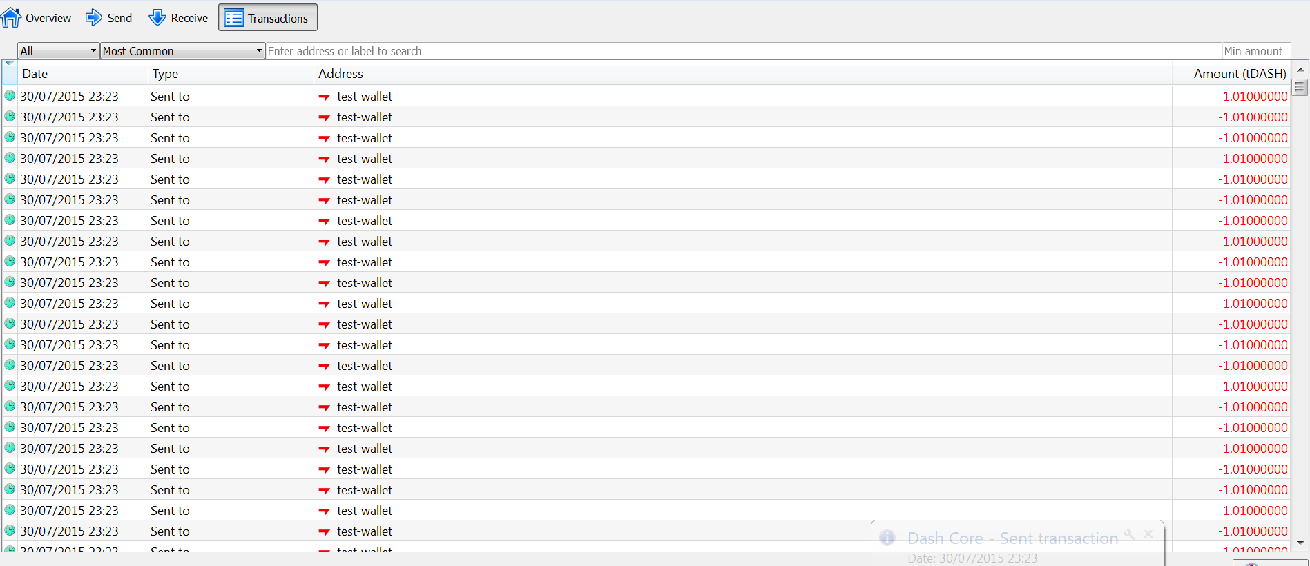

Question: Isn't the TX confirmed only when the "green clock" icon becomes a "check mark" icon? Evan shows a bunch of "green clocks" but I don't see any "check marks".
Hope that makes sense.
Pablo.
The green clock means the inputs got locked up and are safe from double spending, the check mark means the transaction was included into a block. So there simply was no block event on the network while I was testing.

the checkmarks appeared after he put in a sleep command to wait a few miliseconds between each command .. but IX goes so fast its hard to see that.
So it starts with checkmark, get 5 IX confirmations (pretty much immediately) and will then wait for 6th pow confirmation to conclude the transaction.
