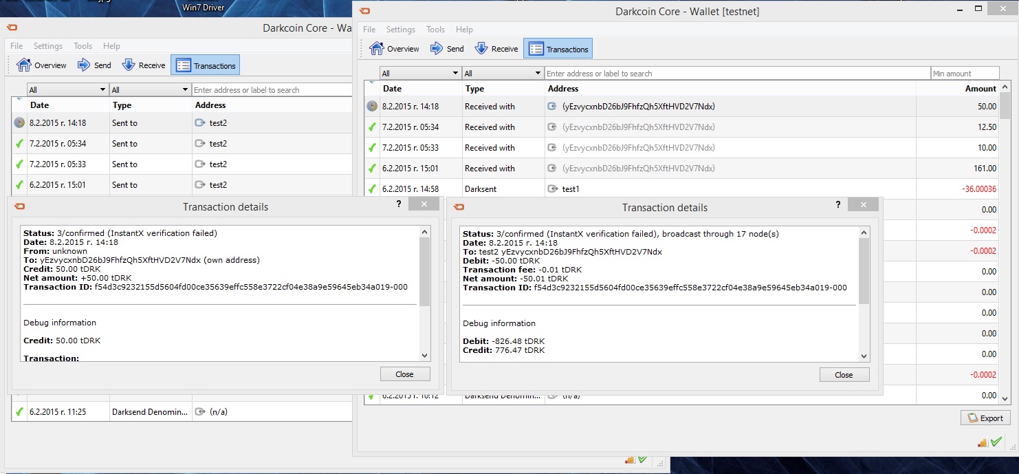

v0.11.1.x InstantX Testing

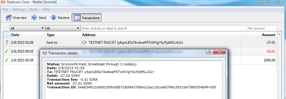

Windows v.11.1.15... Doesn't look like an IX transaction, does it? hmm.....

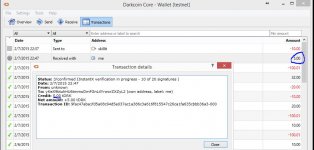

Testing IX with 5 tDrk transaction - seems to be working a lot better than bigger transactions.
I have a few more snips.

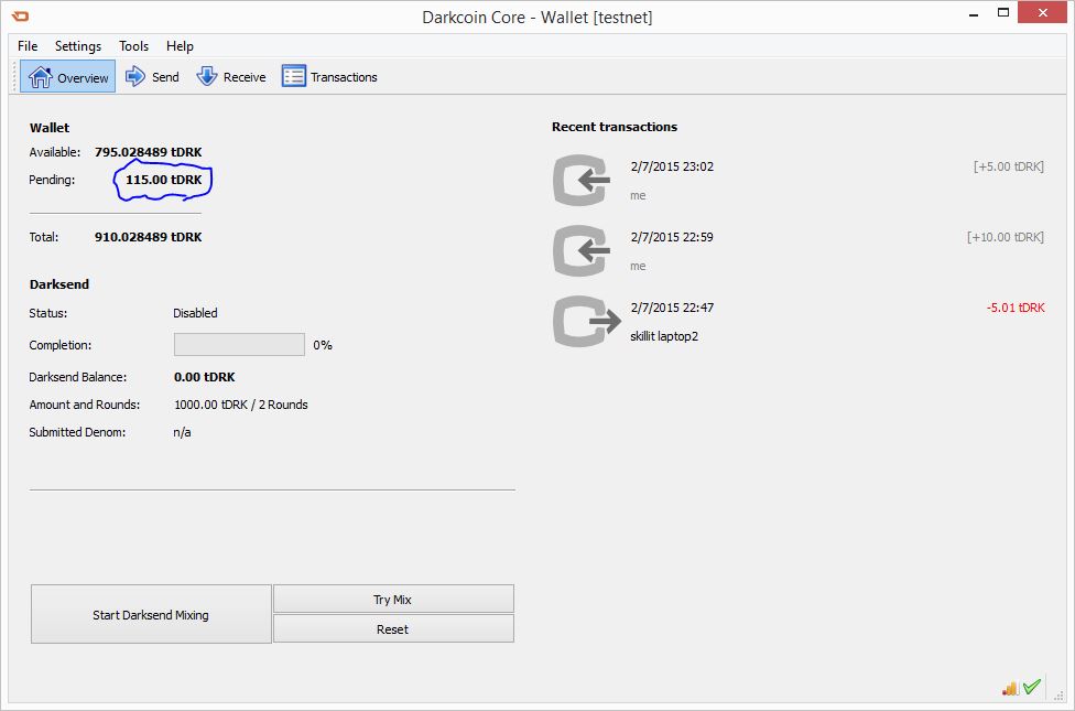

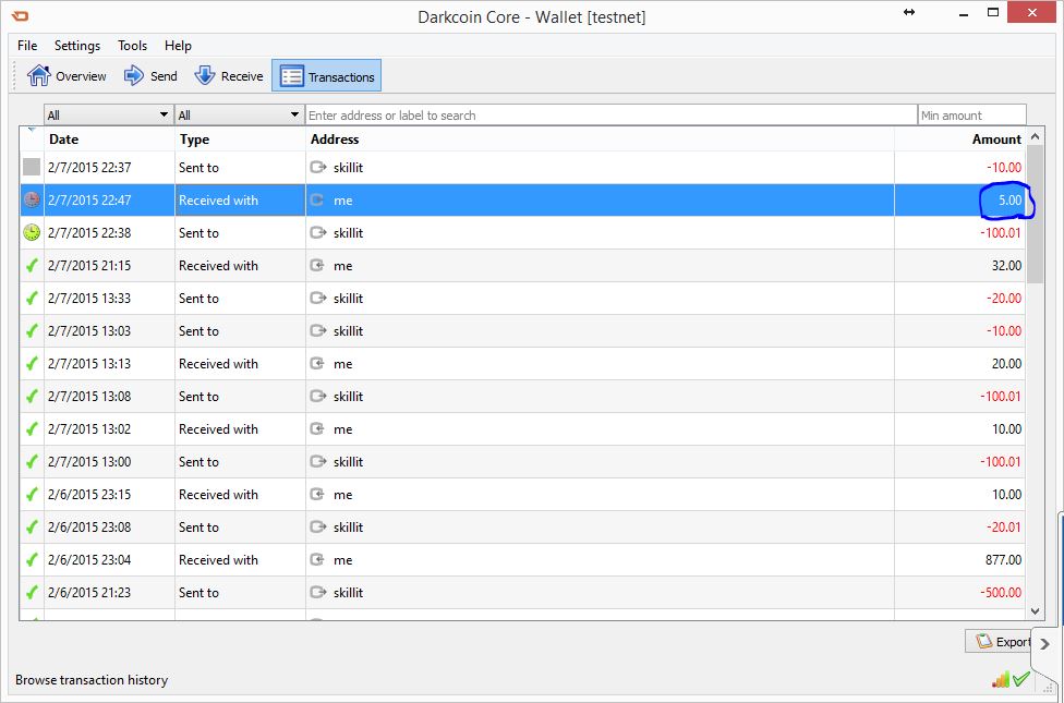

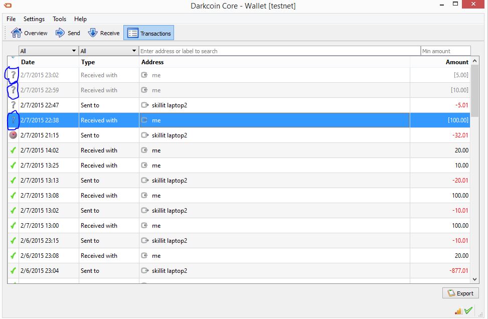

#1 of a 100 tDrk transaction - failed
#2 of a 10 tDrk transaction that disappeared and did not show up in my other wallet, no notification of the transaction at all and on the transactions Tab , it shows a little grey box rather than a clock waiting for the transaction to be confirmed.

Status: 0/confirmed (InstantX verification in progress - 10 of 20 signatures ), broadcast through 12 node(s)Date: 2/8/2015 00:04To: splawik21 yKM7cfYhL3qe4gJLs8ki6xDW1igXa82MJcDebit: -15.00 tDRKTransaction fee: -0.01 tDRKNet amount: -15.01 tDRKTransaction ID: 36df0d1c213012f1ef797c21d71e79f4be19be7b721df589f6683bad74982066-000
Now finally:
Status: 1/confirmed (InstantX verification in progress - 10 of 20 signatures ), broadcast through 12 node(s)Date: 2/8/2015 00:04To: splawik21 yKM7cfYhL3qe4gJLs8ki6xDW1igXa82MJcDebit: -15.00 tDRKTransaction fee: -0.01 tDRKNet amount: -15.01 tDRKTransaction ID: 36df0d1c213012f1ef797c21d71e79f4be19be7b721df589f6683bad74982066-000

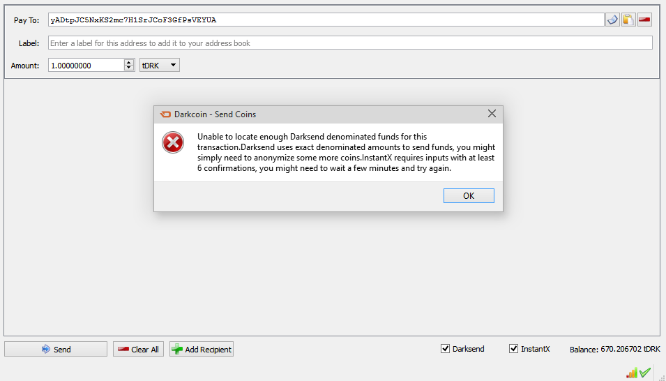

Question: what happens when you run out of denominated coins? Doing IX testing I seem to have ran out of 1 tDRK amounts.... do I have to just resend back to myself to split these up again? Would be really nice if the wallet could detect this and give the option automatically
Edit: mined coins started to confirm and IX picked those up, and started denoming smaller amounts again. Would this have happened again otherwise?
looks like we still have problems getting the MN's to gather enough signatures (it needs 20 of 20) to make it an InstantX confirmation
Status: 0/confirmed (InstantX verification in progress - 11 of 20 signatures ), broadcast through 14 node(s)
Status: 1/confirmed (InstantX verification in progress - 11 of 20 signatures ),
Status: 5/confirmed (InstantX verification in progress - 11 of 20 signatures ), broadcast through 14 node(s)
note : those 1 & 5 confirmed are from POW and this was a darksended InstantX with v0.11.1.15
