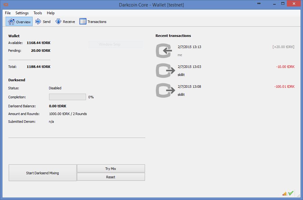

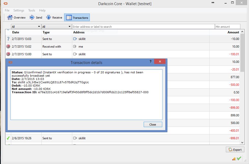

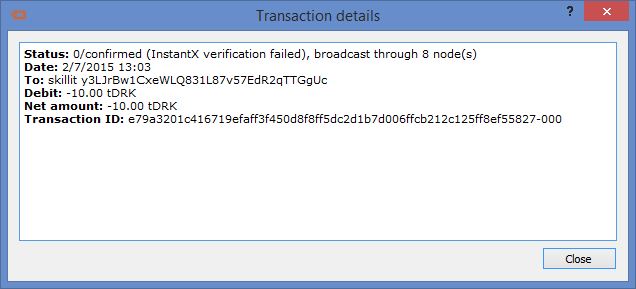

Still cannot seem to get IX to work on my windows machines with the new version. Same issue as before.
3 minutes, 40 secs , 20tdrk transaction , IX
win8 64
this snip is of 3 IX transactions. The first two transactions went through, the third transaction of 10tdrk sent basically disappeared and didn't show up in my other wallet for 5 to 10 minutes later
