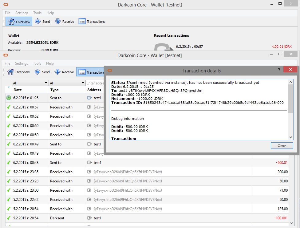

Status: 8 confirmations (verified via instantx), broadcast through 1 node(s)Date: 2/5/2015 23:11To: Sub-Ether yG466d8XLyemNKQCEZ3RReoLNTGwHpjfqqDebit: -15.00 tDRKTransaction fee: -0.01 tDRKNet amount: -15.01 tDRKTransaction ID: 21f4012202bec099de605909dbf1b09b037959ca8caa632c0e21a47a3628e305-000

Happened to me twice in a row, without using coin control. Waited 15 minutes, still no broadcast.
After restart they are listed as normal transaction (as it should be) but never get a confirmation.
-zapwallettxes removes them, but they shouldn't be in this state at all.
yeah, i tried to do that InstantX transaction again after i used -zapwallettxes to get rid of that previous stuck transaction and the new InstantX transaction gets stuck
the exact same way .. eventhough that 1000 InstanX got fully POW confirmed by this time.
There seems to be a problem with outgoing InstantX transactions when the wallet has incoming InstantX transaction as well
(regardless if the incoming InstantX has been 6x POW confirmed or not and regardless which input amount you select).
Status: 5/offline (verified via instantx), has not been successfully broadcast yet
Date: 5-2-2015 23:25
To: Test Darkcoin 2 y3DUP7joBEXH9Cimh4JM3D9thMebDnRwH5
Debit: -859.755 tDRK
Transaction fee: -0.001 tDRK
Net amount: -859.756 tDRK
Transaction ID: 9e826eb3a845f6dbaf33922c67b603fd9ad893d3552c0d7ea7f56bf7b132b666-000

Sent 1000 tDRKs(unmixed) to another address via IX but it didn't receive it.
Edit:
Looks like IX is limited to 999 tDRKs
Received both transactions of 1000 tDRKs after few minutes, but they didn't processed via IX.
