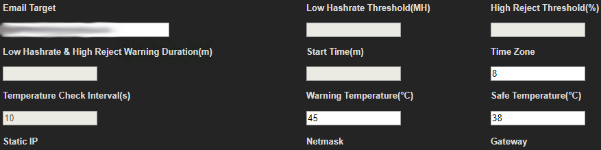

i am curious about what temperatures your machine is reporting after a week of use.
now its high at 39-40.
due to humidity
Hi,
It is possible that the temperatures is causing the PLL to drop lower than 380, which would affect your hash rate. Usually when the temperature gets around 38-40C, it would start to lower your PLL. If you can try to keep your temperatures below that, you should get back to normal hash rates.
