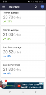

does your company plan to introduce a firmware that can mine ither algorithms like what baikalminer has done?
attached image is for 2 units already. its like dm11... huhuhu
