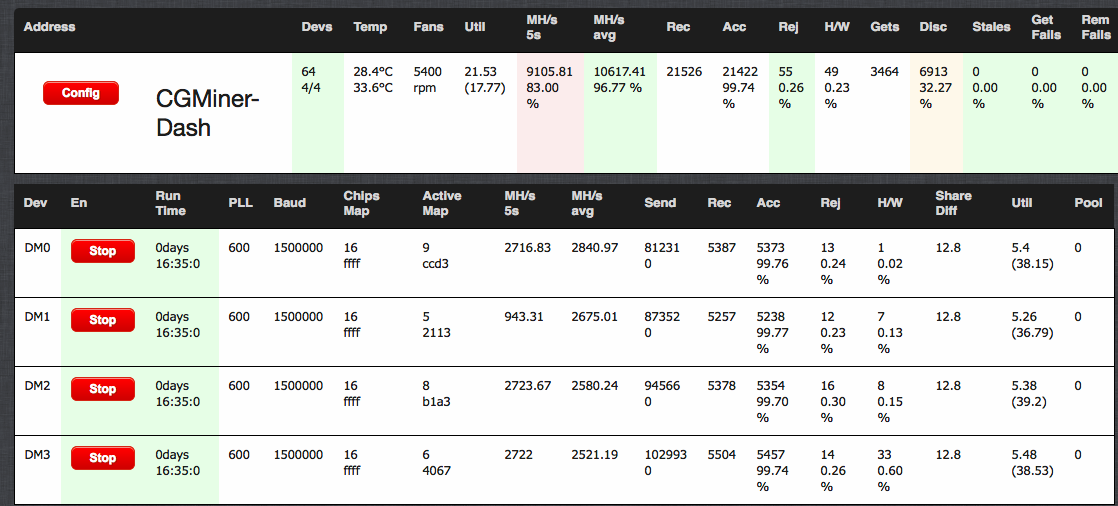

Looking for some help understanding why our active maps are changing frequently.
Currently mining at NiceHash with the latest firmware, IB3.5.25.
When I restart, I usually achieve 16 for each blade in the active map.
Temps seem fine in the 28-32°C range.
After mining for a while, one or more and eventually all of the blades' active maps drop from 16.
Mining returns suffer when the active maps aren't 16.
Any ideas?
Here's a recent screenshot:
Hi,
It is normal for the active map to change as it is affected by difficulty. It is just a status indicator of the chips getting work to do.

Thanks for the explanation!
I do notice when we restart, we seem to jump right back to all active maps=16 and our accepted hashrate and payouts climb back to the top. It seems like it's beneficial to do this periodically during the day, but it would be nice not to have to watch things so closely.
