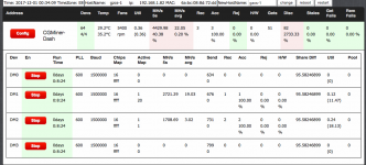

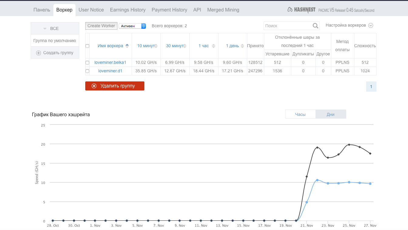

Hello Everyone.
please advise me regarding ant pool for Dash while i am using Ibelink 11g
Please check attachments is it normal to get so many discards as i do (1-t image)
Also i found that average hash rate in this pool is 1 gh lower that 11. it s actually hash rate is 10.
Can anyone tell me answers for all this questions?
best regards

Hi,
You do not need to worry about the discards too much. Discards are work from blocks that are no longer valid to work on. This is usually due to latency with the pool, difficulty or even if the pool uses profit switching. There could be a difference in how ant pool is calculating hash rate compared to the miner. The miner is showing an average hashrate of about 12Ghs. I am not sure if anyone else mining on ant pool is getting the same thing.

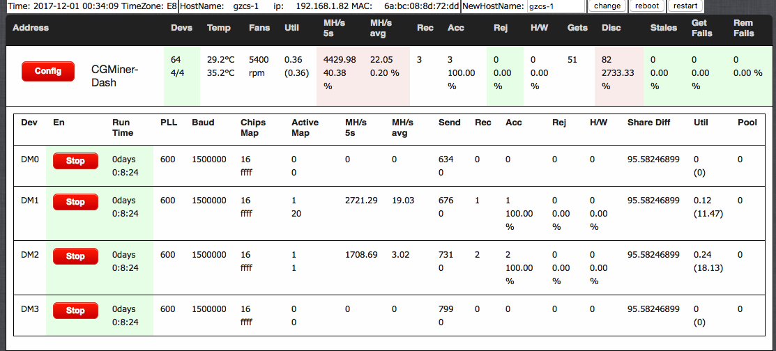

Hi,
None of the lights are lighting up on the front of my dm11, but the lights for ethernet are on at the back, as well as the fans. can you explain how to reseat the sd card? i#m guessing i need to open the case
Hi,
Hi,
Yes, you will need to open the case. The controller board will be located on top of the psu. The sd card should be located at the top left corner of the board. If reseating the card doesn't work, you can try to re-image the sd card with the DM11G firmware IB3.5.25
