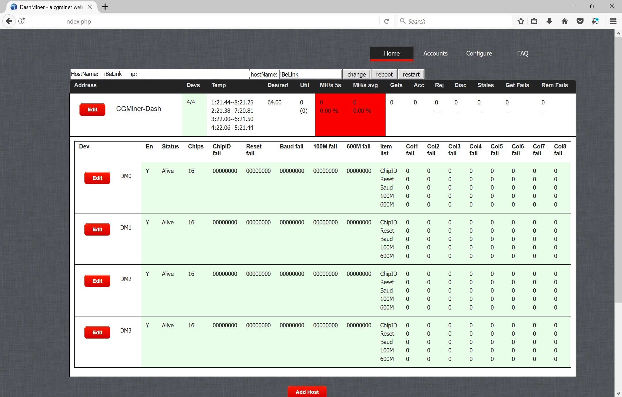

Sorry for the delay. Screenshot attached. I'm about to throw this thing out of the window. It's in a basement, It's fall and getting cooler. There is no good reason why the hashrates fluctuates so much. It just seems like bad manufacturing process.
[UPDATE] What kind of troubleshooting users are allowed to do that won't void warranty? Do we need permission here or at the iBelink website? I have gone through most of the postings here that may be related to the problem, but haven't really seen anything that could provide clues of what needs to be done, short of submitting a ticket for a warranty repair.
Thanks.
Hi,
The hash rate you are referring to is actually the MH/s 5s for the individual Blade. It is the average hash rate of the last 5 sec for that 1 Blade, which can fluctuate very much. What you need to look at is the MH/s avg at the top. Looks like you are getting ~10gh/s.
What kind of troubleshooting were you thinking of doing? As long as you don't add/remove parts to the hardware, make changes to the firmware it should be ok. If you want to check, you can always ask here or in a ticket and we will assist you.

Hi,

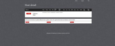

Hello Everyone
i tun ibelink for 1 mounts and i didn't get any problems
but now i move it to other place so this place require to change IP address.
i follow instructions, but after changing IP i had this message ( please check attachment)
all options (roll back, reboot and etc) doesn't help, also when i turn off and than start it again still have mistakes
So how to do?
How to change IP correctly, please advice me ASAP
Also i am interesting q-ty of discards is different for pools or no? and whats the normal q-ty of discards?

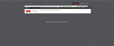

Here are more details about situation
Also i need to admit that after changing IP DNS and etc he start to reboot every few minutes.
we change ip address from default 192.168.1.120 to 192.168.0.120
and when we go after reboot to ip 192.168.0.120 we found mistakes as i sent you in attachment.
code of mistake is “Connection to failed: ‘Connection refused”
after this we try reboot, restore, rollback, nothing help ip still 192.168.0.120
than we go to plug out from device, wait little bit and than turn it on.
after this ip address become 192.168.0.109 and when you go this ip you can see mistake again
Please check attachment
Please reply me ASAP,
Hi,
It is possible that the sd card image has gone bad. Please try to re-image the card and try again. Discards depend on many factors, could be from network related issues or from pool settings. There is really no "normal" quantity of discards.
