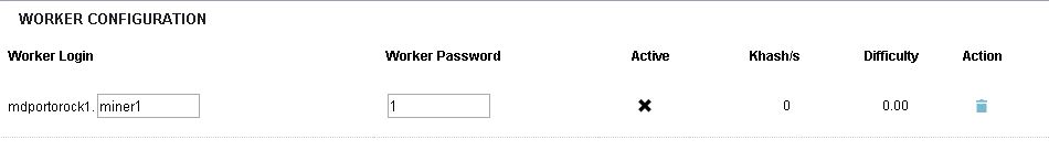

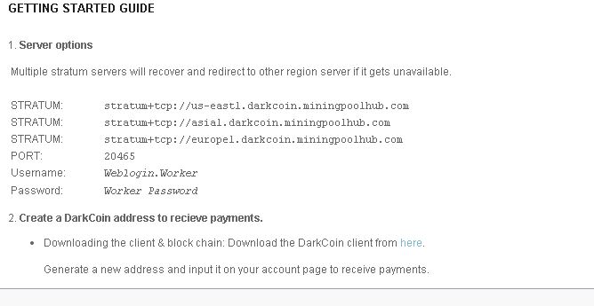

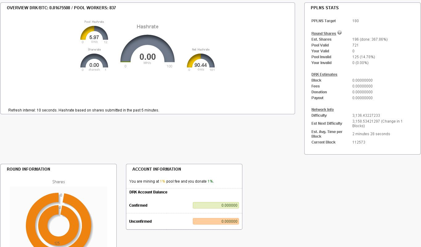

My question is a- does sg miner look like it's working? if it is woirking then why is there no info for my miner and an x showing under active?
screen shots attached.

Looks good. How long did you wait to take the screenshots of the pool interface? Did you try another pool yet?
I waited maybe like 30 minutes..is that long enough? I will try another pool and see what happens. How long should I wait?

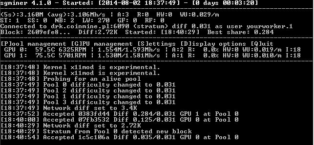

It seems you're looking at the wrong pool. You miner screenshot says your mining drk.coinmine.pl with worker as yourworker.1, while the pool screenshots and config files are for miningpoolhub.com.
You probably executed the wrong bat file.

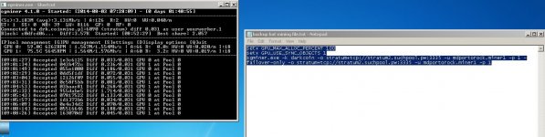

i changed pools and this is what i have.
Same thing dude. Config file points to suchpool.pw, but you're still really mining coinmine.pl. File name says "backup bat mining file.txt", so its impossible you're running that.
You're editing the wrong file, or save this one and rename to .bat, and run it.

Thx man, I get it now. Weird thing is that i saved the backup bat file to a bat and ran it but it still shows that I'm mining from coinmine..?!?
I actually opened a conf file and I see the problem now. It's pointing to coin mine. i will change it and post a screen shot soon.
