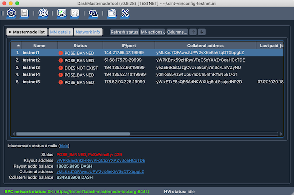

I've been asked a few times to implement dark mode in the app UI. From now on it is possible to change the theme to dark, even on systems that do not support it natively like macOS. To enable it, open the settings dialog, go to the "Miscellaneous" tab and check the "Use UI dark mode" option.
Here is a preview:
On macOS, you can now also use a native dark theme, but it looks a bit different that this multi-os solution. To use the native macOS theme, uncheck te configuration option mentioned above.
