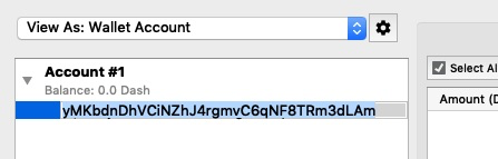

Below are the steps that should be done to run a testnet masternode with Trezor:
1. Connect your Trezor and run the wallet window in DMT by clicking the tool button with a brown wallet icon on it.
2. On the left side of the wallet window, a list of BIP44 accounts is displayed, similarly to the Trezor online wallet. If you have not used the Trezor device on testnet before, you should only see one item, labelled as "Account # 1". Click the expand button on the left side of the label to show the first fresh tDash address (it will be displayed in green).
3. Double-click the address and copy it.
4. Send 1000 tDash to the address - it will be your tMN collateral. If you have a problem with getting this amount, PM me - I have some spare and can share it.
5. When entering the masternode configuration in DMT, click the "Locate collateral" button to let the application find and automatically fill in the collateral address, path, TX hash and index fields.
All other actions to be carried out are essentially identical to those for a normal masternode.

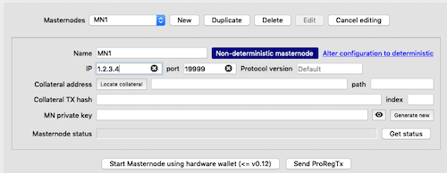

After installing and configuring the Dash daemon on your VPS server, you must notifye the Dash network about the new masternode:
a) If spork 15 is active (as is currently on testnet), click the <Send ProRegTx> button at the bottom of the main DMT window to start the "ProRegTx" wizard.
b) If spork 15 is not active, first broadcast the masternode start message by clicking the <Start Masternode using hardware wallet> button, and after eraching the status "ENABLED", do step a)

Notes on starting masternodes.
In the period of coexistence of v0.12 and v0.13 nodes, starting a masternode should be carried out with some attention
A. Before Spork 15 is active on mainnet:
  • When starting v0.12.x masternode, send the "start" message in a traditional way, that is by pressing the <Start Masternode using hardware wallet> button. In your masternode configuration, enter this protocol version: 70210.
  • When starting v0.13 masternode, first send the "start" message by pressing the <Start Masternode using hardware wallet> button, using this protocol version in your mn configuration: 70213. After the masternode is enabled, register deterministic mn from a wizard started by pressing the <Send ProRegTx> button.
B. After Spork 15 activation (it will be announced):
  • only register deterministic mn from a wizard started by pressing the <Send ProRegTx> button
***EDIT: Look at @UdjinM6's post below, specifying the scenario in the context of DIP-3 activation.
Documentation of the deterministic mn registration process: https://docs.dash.org/en/latest/masternodes/dip3-upgrade.html#masternode-registration-from-dmt
Deterministic mn registration with DMT can be carried out in one of the two scenarios:
a) automatic, in which the public RPC nodes maintained by me, send ProRegTx transactions on behalf of the user (I pay tx fees),
b) manual, using your own RPC node.
