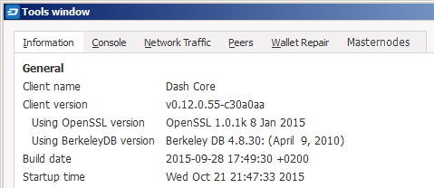

Nope, my plan is to add another tab to the "Tools" window, like this:
I've been playing around with this again today and getting on ok with clientmodel and rpcconsole, any thoughts on what info to show in there? This was just a few routines to get comfortable with it and I'll get things more detailed like the "Number of Masternodes" string in the information tab but I'd likely add too much information so could do with knowing what's actually wanted in there.

Most people would like to see the budget stuff like displayed here: http://178.254.18.153/~pub/Dash/masternode_payments_stats.html
Since the number of budget-proposals isn't fix a table is needed for all that information. Have a look at transactiontablemodel.cpp, transactionrecord.cpp, transactionview.cpp and transactionfilterproxy.cpp to get an idea how it's done.

Thanks :) I was trying to bite off a bit too much earlier with QGraphicsView and interactive widgets but this is mostly copying existing parts with a bit of tweaking so it's fairly straight forward and I'm getting up to speed and finding my way around better now. I'll see if I can get a table in there tidily, trying to keep it nice and clean like the info tab but might be able to do something with summaries and expanding with detailed info but the working out for the payment info will take me a while, nice to have those tasty figures in there though :)
