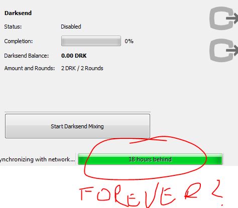

I have v0.10.15.16
Darksend disabled
But, it's been locked in this stage forever (I just bought several hundred Darkcoins, otherwise I would not worried too much):

I have v0.10.15.16
Darksend disabled
Stop the wallet, remove the file peers.dat from its folder (maybe by chance you were only connected to peers which were on a wrong fork) and start it again.
If that shouldn't fix your problem remove the local blockchain (folders "blocks" and "chainstate") and resync from scratch.
Oh, and while you're at it, install the current version v0.10.15.17 !

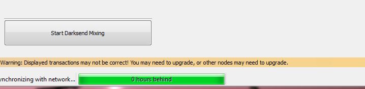

Upgraded to v0.10.15.17 but this is what I get. It's closer, from being stuck at 18 hours behind now I am stuck at 0 hours behind :)
But, all else what you told me (peers.dat etc.) is Greek to me, I'm an aging gentleman still dreaming about the freedom and thusly buying a falling knife full of faith. BTW - it is still "synchronizing" as I type, but those few hundred Darkcoins I just purchased arrived and are confirmed??
