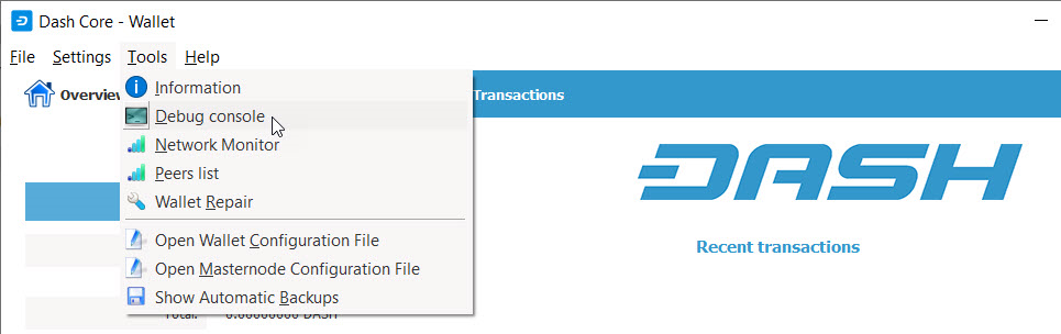

Open the debug console:

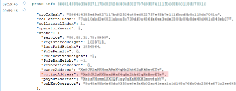

Using that hash, get the address for voting using the debug console with the command:
protx info <your proTx hash>
If you are going to vote from the debug console on this wallet, you don’t need to dump the
private key. Scroll down for instructions on how to vote from the debug console. However,
if you are going to vote from DashCentral.org or from a different wallet you will need the
private key. It is a good idea to check that there is no Dash stored in that address. One
method is to enter the votingAddress into a blockchain explorer:

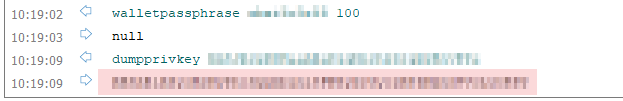

Knowing there is no money stored in the voting address, you can safely dump the private
key for the voting address with the commands:
walletpassphrase <your passphrase> <seconds to keep wallet unblocked>
dumpprivkey <votingAddress>

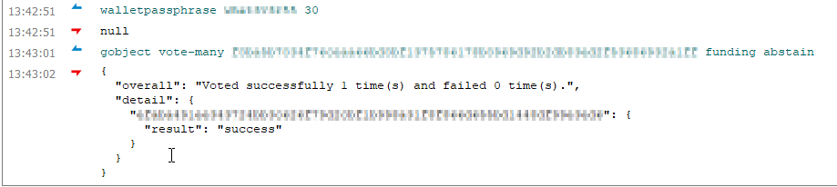

When a voting key is imported into a Core wallet, you do not need configure anything more. You can begin voting immediately. If you forget to unlock the wallet, the software will not inform you that there was a problem. It will simply report that you voted successfully 0 times as seen here:
To vote, run the following commands:
gobject vote-many <proposal hash> funding <yes, no, or abstain>
If multiple private keys for multiple votingAddresses are imported into the wallet, the vote-many command will vote the same way for all of them.
