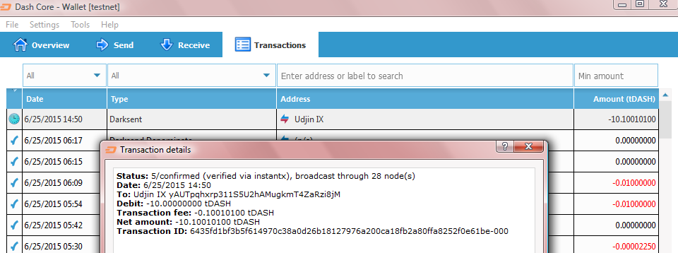

And 10 / 10 instantX success rate,
Evan and Udjin may have hit the sweet spot this time :cool:
I agree, just tried several IX's, all worked. We are getting there! This testing thing is pretty fun...

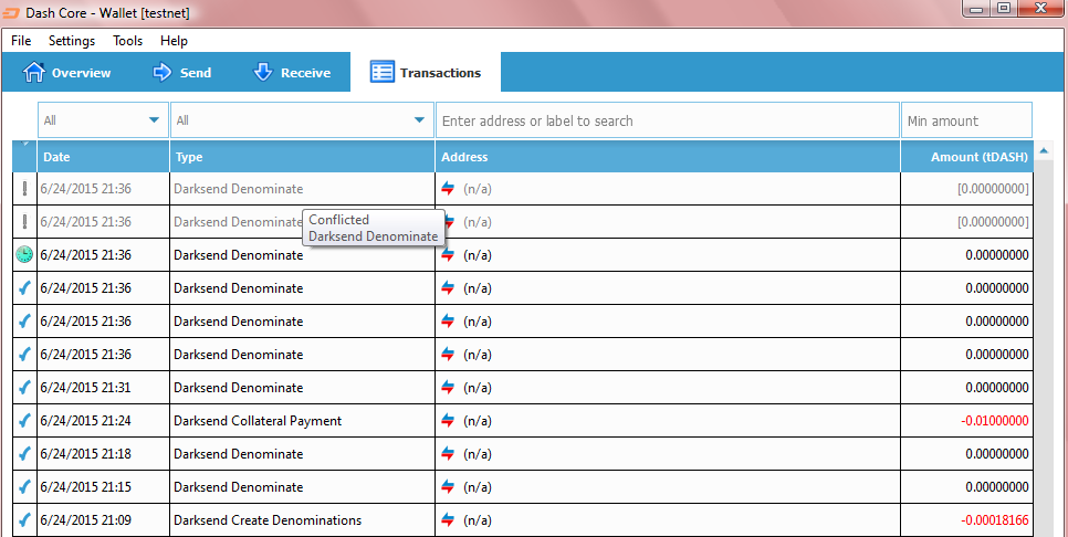

eduffield UdjinM6 - One of my wallets has "Conflicted Darksend Denominates":
EDIT1: UdjinM6 - A second wallet also has a Conflicted DS Denominate, and crowning, -reindex from "Wallet Repair" crashed both of my wallets when I tried using it. (windows 32bit).
EDIT2: crowning - Found my error. I had "-listen=0" in the shortcut target and that was why I couldn't use reindex. Removed that and it worked.
EDIT3: crowning - Actually, I just looked at my wallet and the conflicted tx's were still there, -reindex didn't solve (because I guess it wasn't the right tool). So, I used -zapwallettxes and that solved it. Now I'm guessing I found why my wallet crashed when using -zapwallettxes the other day, it's "-listen=0".
EDIT4: crowning - Sorry to bother you again. But I think all these problems are windows problems. After I got that wallet fixed, I closed it. (And i put "-listen=0" back on). Then I tried to open two wallets (on the same computer), they both stopped syncing.. I used reindex button again, it started the process but didn't sync through. I then deleted Dash-QT Testnet in the registry, restarted and reindexed again and they went fine. So I think your reindex and zap buttons work fine, it's not the ports that cause problems like i thought, it's just windows that needs some adjustment, unless you can do magic that no matter how bad windows is, your buttons can bend it.. :)

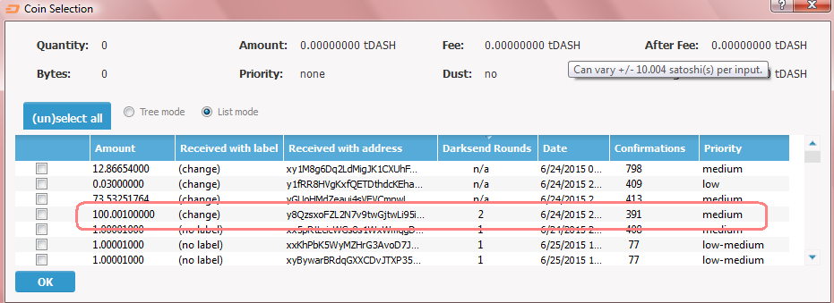

BUT wait! Hold on to your seat, we're not quite there yet! Because I want to send Udjin 50 dash and it says I can't...
There's a 100 dollar bill dash amount that DS can't break!
