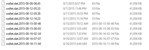

I think there is a string overflowing on the automated backup... See screen shot...
