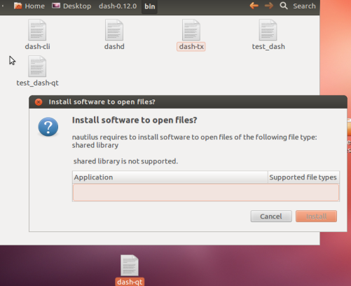

I might just be having a retard moment here but i cant seem to get the new qt to open when I try to open this comes up:
and when I search for an application nothing is found :P
what am I doing wrong ?
Edit: Im running 32bit and thats what I downloaded, tryed to download again just to be super shure
see post 533 (2 pages back) from crowning, could be related
Edit : damn, I got ninja'ed :grin:
Thanks crowning for your tip , Im shure It works fine but I cant use the terminal that well (all kinds of silly things happen like arrowkeys turn into ABCD and such) So I tryed just doing it on the desktop what is the file type? Course it just opens in the text editior when i open it
Thanks crowning for your tip , Im shure It works fine but I cant use the terminal that well (all kinds of silly things happen like arrowkeys turn into ABCD and such) So I tryed just doing it on the desktop what is the file type? Course it just opens in the text editior when i open itView attachment 1799
The follow works for me:
-drag 'bin' folder to desktop
-open terminal (ctrl t)
-in terminal go to bin directory on your desktop from step 1 this is done using the following command
cd Desktop/bin​
Now run the dash qt using this command
./dash-qt​
I know you can normally just double click the icon but if you get that error message your getting this will work.
cd Desktop/bin​
./dash-qt​
*edit removed extra quote
Thanks this worked for me :D
But dont see why this extra step is necessary, something the devs can fix in 2 minutes im guessing :P

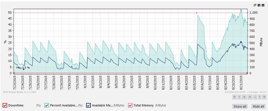

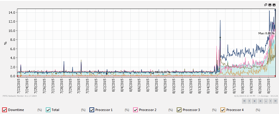

Here's some performance charts from my masternode.
I've got 1GB of Ram assigned to this VM.
Any guesses when I upgraded?

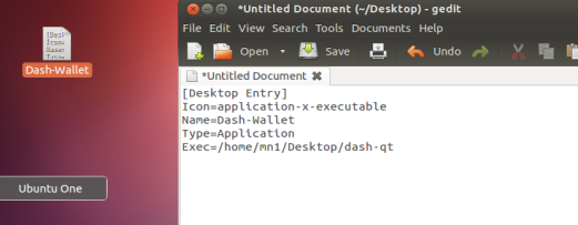

Sorry, my fault, the newly created file needs to have the extension .desktop and must be made executable.
I've fixed my original posting, see https://dashtalk.org/threads/v12-release.5888/page-27#post-64331
I agree.. it's usually only when the update first comes out though. Try download again in a few days maybe. :) also, just fyi, press up arrow key when terminal open and u can re use previous commands. :)
