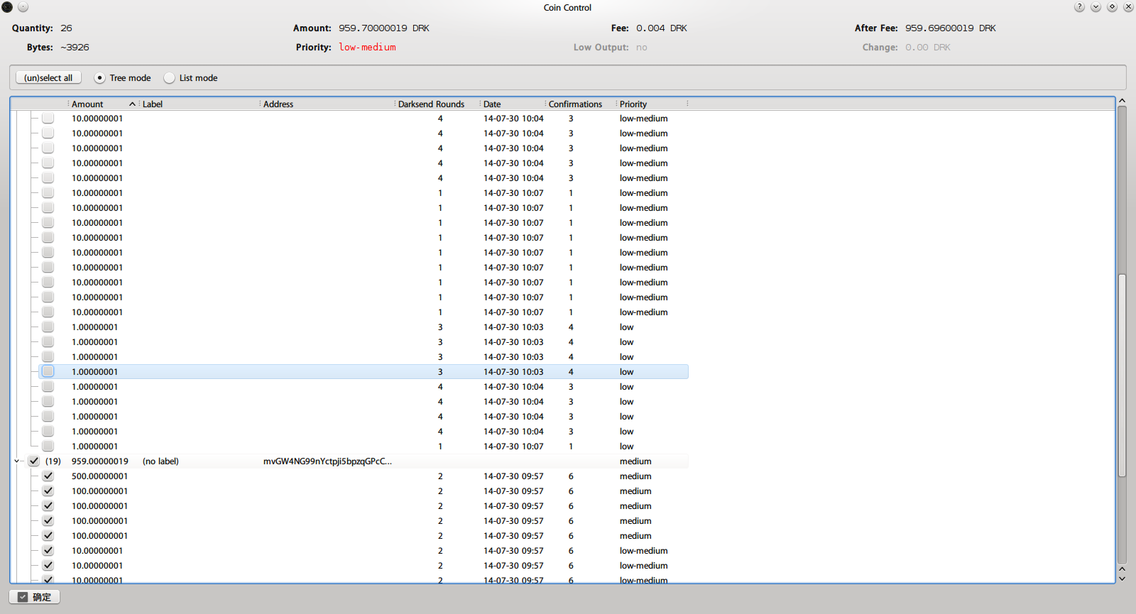

Latest Wallet with 1000 DRK - denominations look good. Any concern for the last 0.597997 as a non-denon input?
Apart from that things are looking Solid!!! Denom did not take long at all!! Great work Evan!!!
I confirm too. My denominations were quickly and correct. See it there http://test.explorer.darkcoin.qa/address/mtCXjegAi8FcJmwTbj8Pmaa3ZKdxpDY2YW. So, I think I understood the technology and it works fine. Here the tx http://test.explorer.darkcoin.qa/tx/ca623d70441870c37690330ab31a075c0d3b4fb5f22faa4706efedf07815d620 with 2 output addresses which have equal balances, so third-party can't determine which is mine. But why there are only 2 addresses?
P.S. Maybe my question is stupid? ;)
P.P.S. I sent one more 1000 DRK to public address and them denominated to my final address. As I understand somebody can send two test payments to both start addresses, i.e. 2 and 4 DRK and see, where they are going and track DRKs. I'm wrong or not?

What is latest version number? My client seems to stuck trying to denominate.
I appear to be on: v0.10.12.9-2-g06365bc-beta
