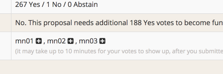

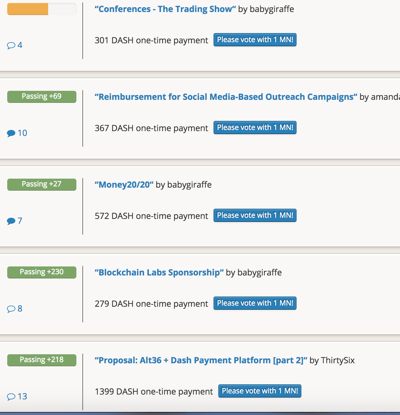

My masternode votes show the three plusses when I click on the proposal, but the main page says one vote has not been made, for every proposal. I attach screen dumps.

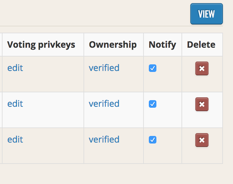

Well, all three masternodes are showing as verified. There is a button to remove verification, which I suppose I could press, but otherwise I don't know which one might be failing and I don't see any issue with the verification.
i had exactly the same thing !
(let me find what range suggested) ....
there we go:
(follow this)
Please check your voting privkeys.
Masternodes => edit => edit voting privkeys
