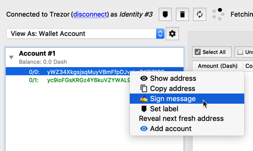

Unfortunately the DashMasternodeTool does not seem to permit you to sign a message from such an address. Which is probably obvious because you never gave to it any private key, so how could it do it.
DMT allows you to sign message with any key controlled by your hardware wallet.
If the Dash address involved isn't the same as the collateral address, you need to follow these steps:
1) launch the DMT wallet window
2) on the left panel locate the Dash address associated with the key you want to sign message with
3) right-click on it and choose "Sign message"
