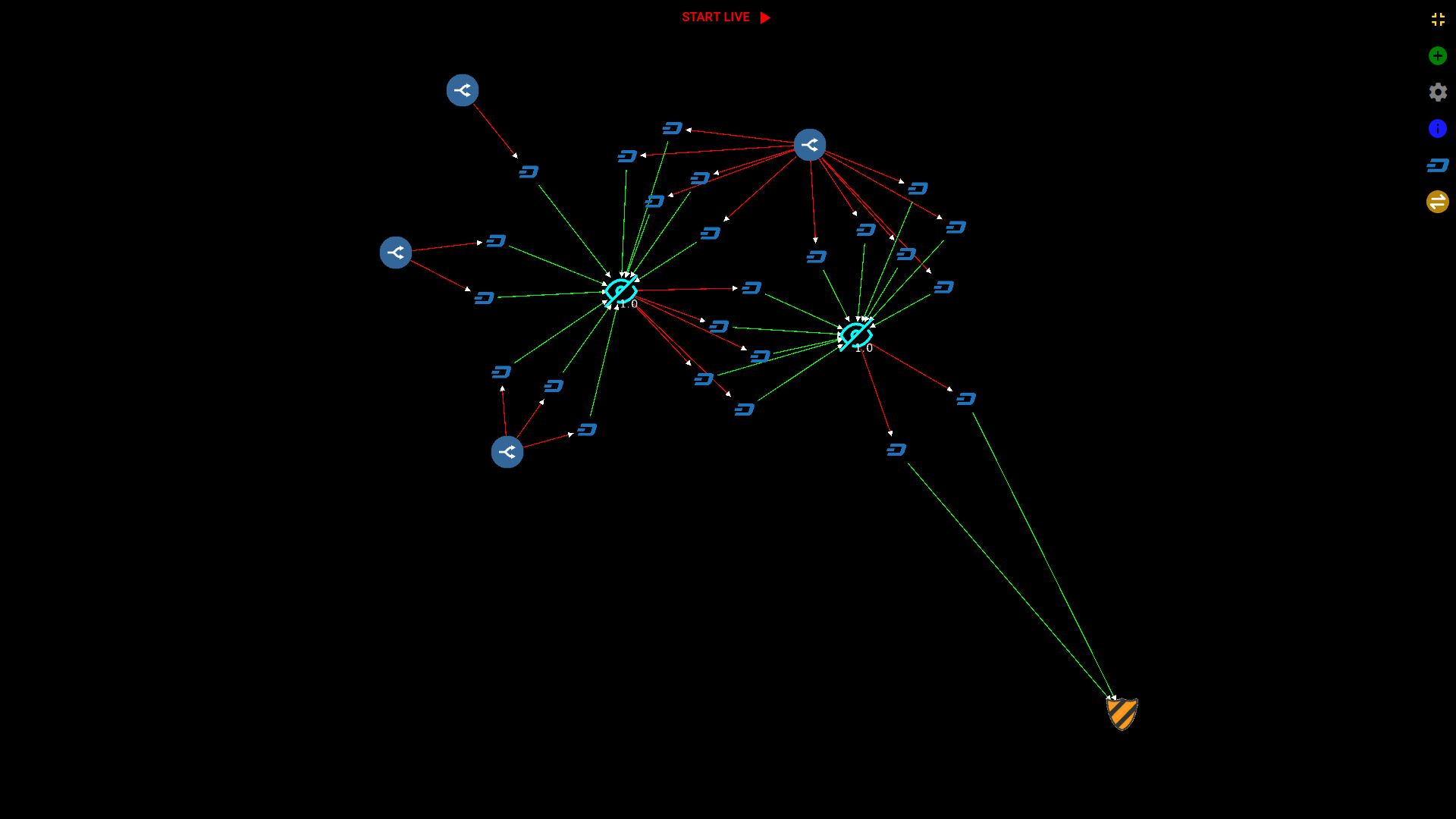

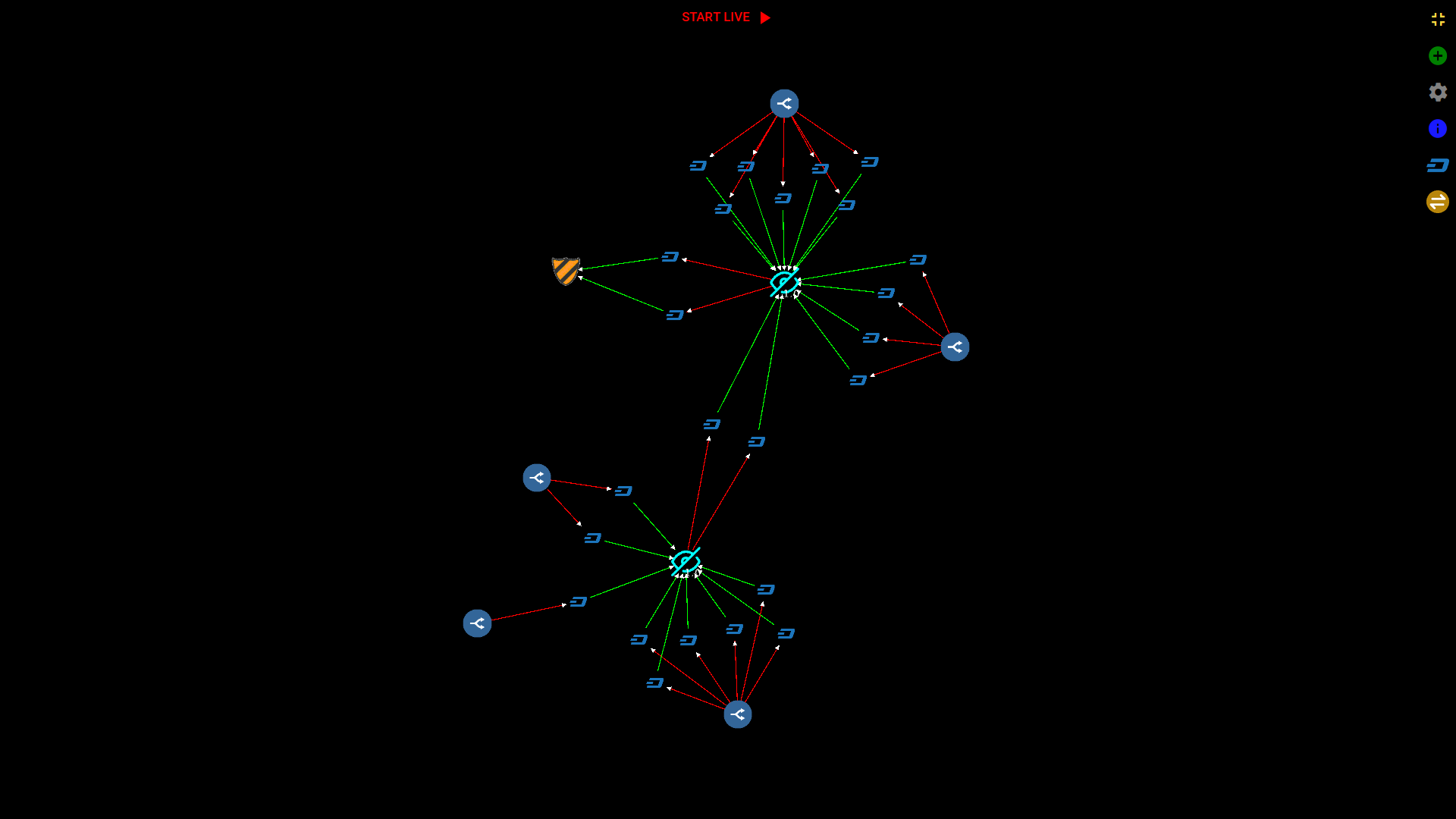

Today I decided to search the blockchain for privatesend inputs that can't be using more than 2 rounds. I found several such transactions.
Here are 3 examples:

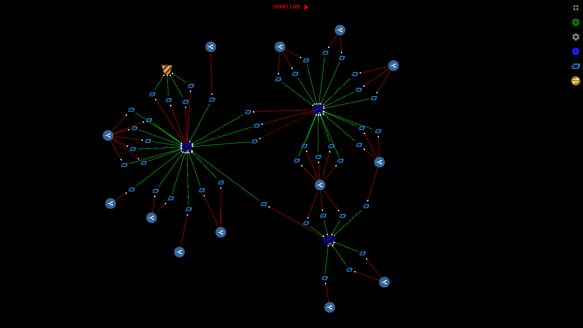

1:
dashradar import json
2: Only 3 possible mixing sources (create-denominations transactions). Actually only 2 because there is only one connection to one of the create-denominations tx so the other PrivateSend input has to go to one of the two other ones.
3:
All the inputs of the mixing transactions in the images are expanded and there is no path to a 3rd round. Basically the first example has 4 possible create-denominations transactions. Second example has only 3 2 and the last example has 7.
The data in the json links can be imported to https://dashradar.com to reconstruct the graphs.

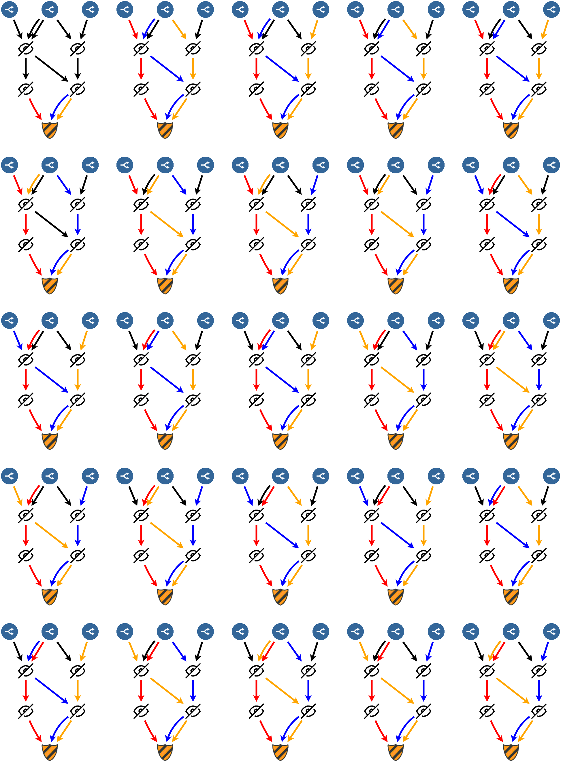

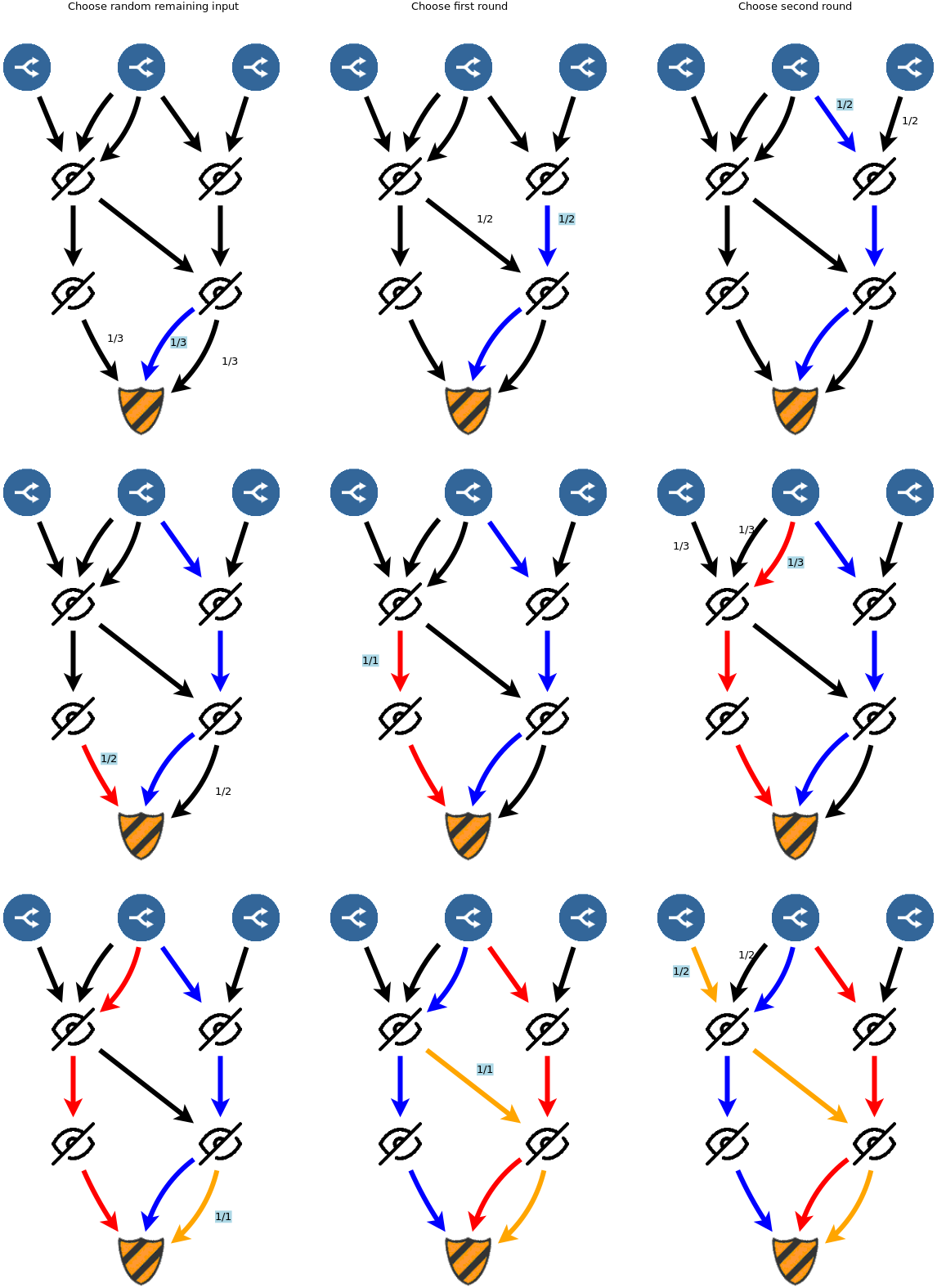

I made two diagrams in an attempt to better explain what I'm doing.
In both diagrams I use an example of a PrivateSend transaction with 3 inputs: red, blue and orange. The remaining graph contains all the possible 2 round paths to PrivateSend create denominations transactions.
In the first diagram all 24 of the possible mixing combinations are displayed. In each combinations, multiple inputs are allowed travel through same mixing transaction, but they are not allowed to share common edges because that would mean that a single transaction output was spent twice. It is practically possible compute all the possible mixing combinations when the number of PrivateSend inputs is low and/or the number of mixing rounds analyzed is low.
The second diagram shows how it is possible to generate a single random mixing combination. This process can be quickly repeated a lot of times and then the randomly generated combinations can be analyzed to determine if the PrivateSend transaction is secure.
In this specific example both methods would come to the conclusion that the PrivateSend transaction is not secure if it used two rounds, because in all of the mixing combinations shown in the first diagram, there is at least one input mapped to the create denominations transaction in the middle.

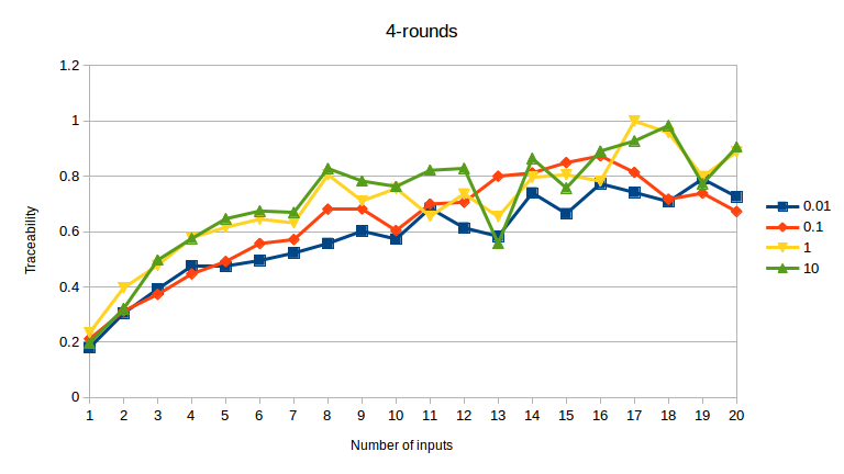

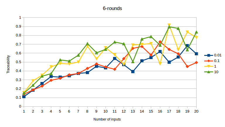

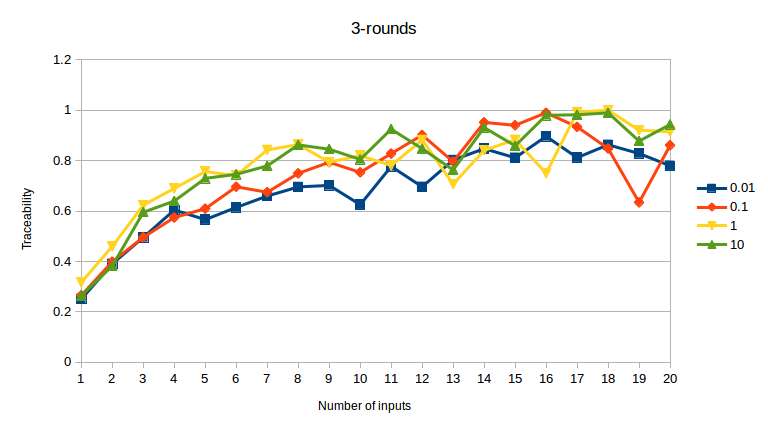

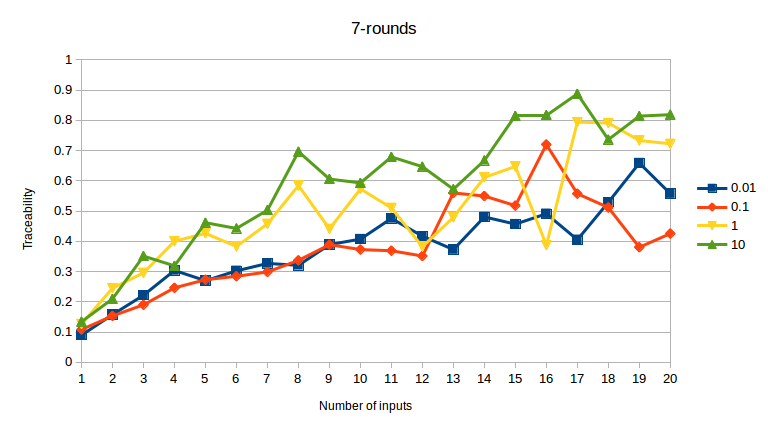

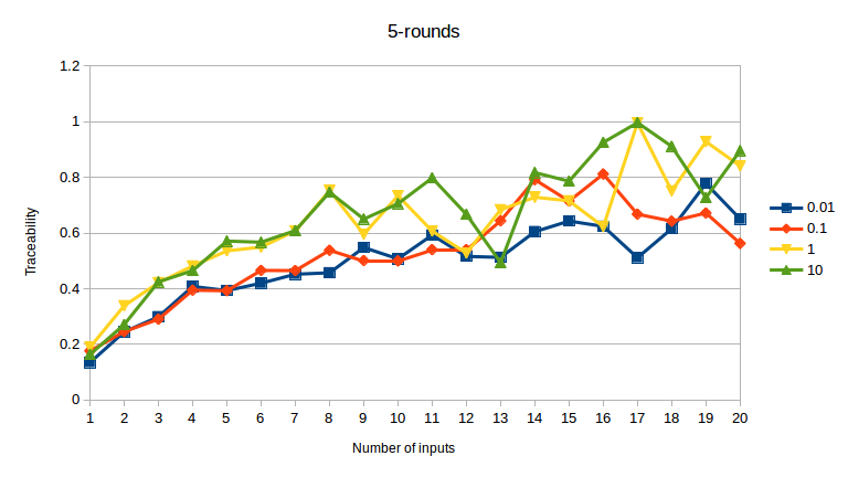

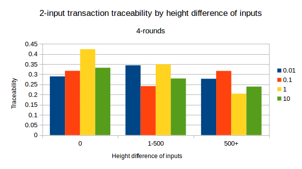

I made some charts to see how the number of inputs in a given denomination affects privacy.
The series (0.01, 0.1, 1.0 and 10.0) represent privatesend transactions that contain inputs only from the specific denomination.
The y-axis (Traceability) is the average percentage of the most often appearing mixing source(create denominations transaction).
The x-axis is the number of inputs.
There is a lot of variance when the number of inputs is high because PrivateSend transactions that use only one denomination and have many inputs are quite rare.

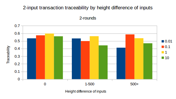

Next I'm probably going to study how much it affects privacy if many PrivateSend inputs are from the same transaction or time period. I think that the privacy will be stronger for PrivateSend transactions where the inputs are many blocks apart from each other.
If you are a masternode then please vote on my proposal here!

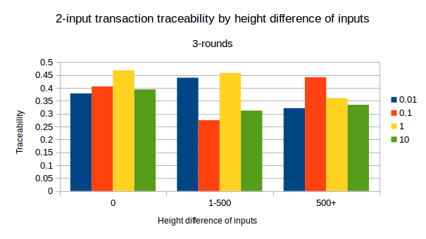

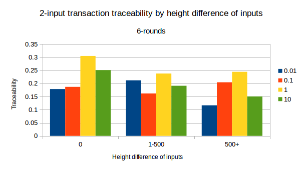

2-input PrivateSend transaction charts above. I would have expected PrivateSend transactions where both inputs are from the same block to have significantly worse privacy but that doesn't seem to be the case. Sometimes it is even the opposite. I guess there might be too little data to analyze 2-input transactions reliably.
