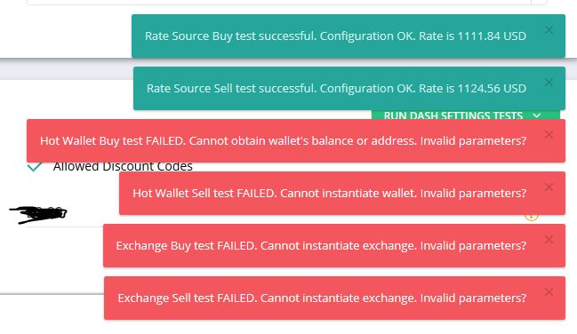

With wallet unlock and not encrypted, I still get :
This is the string I'm feeding the GB system (with obfuscated user and pass):
http:myrpcusername:myrpcpassword:127.0.0.1:9998:Xu7ioVCwWKc392caksqQyk3jx796vTg4UH
Any ideas what is happening?

When I put that command in the console debug I get an error. I can do the getnewaddress testaccount but not the dash-cli.
Still failing for me.
dash-cli commands give me an error:
15:12:16
Method not found (code -32601)

We figured out the steps!!! Here's the complete recipe (or most of the steps anyways). Thanks for the info above; it helped us to get it working. Hopefully this will help others to get theirs working, too. :-)
