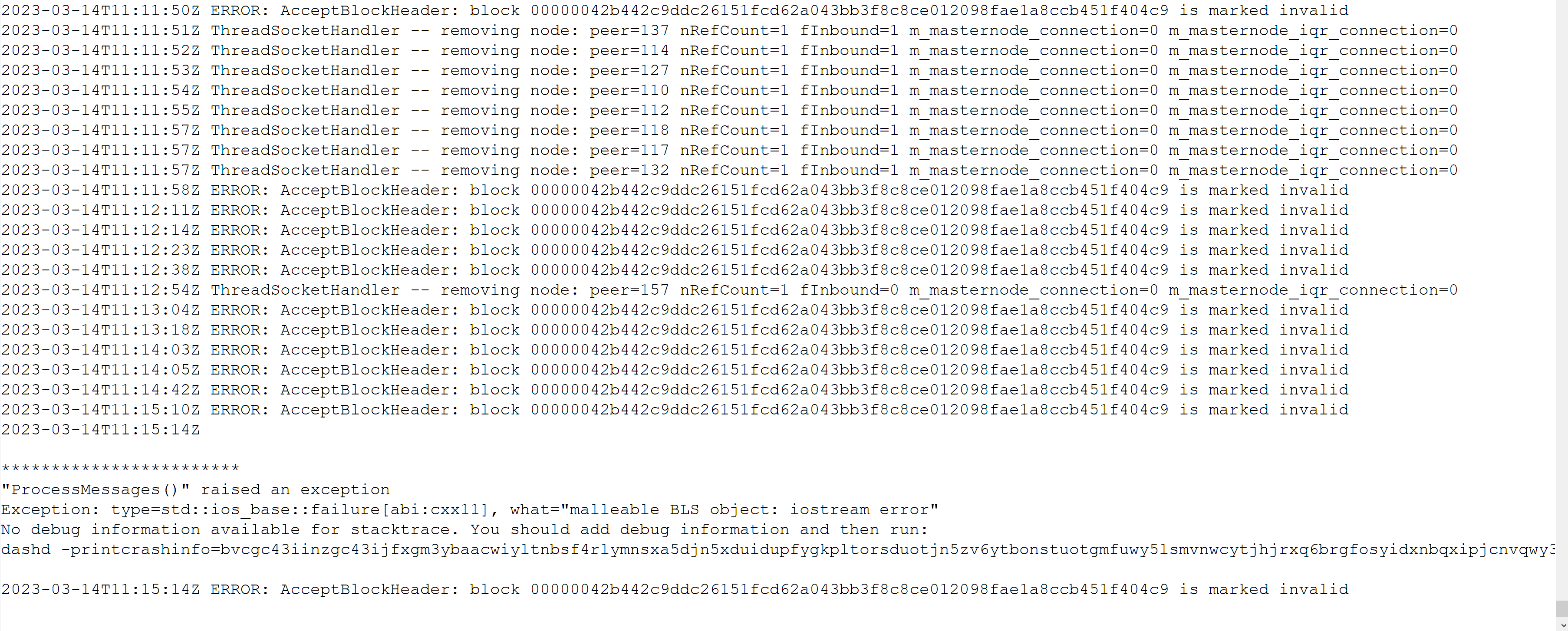

I am starting to see this in a masternode that is downloading from scratch (deleted testnet3 folder) with v19.00 RC6
Anyone else noticing these errors in their debug.log ?
Blocks and Revs have stopped increasing after blk00018.dat & rev00018.dat
@xkcd Do we need to do a reindex, even when downloading from scratch ? I will try that, to see if i can get going again.
@xkcd Did Testnet just forked or something ? Do we need to do a reindex even when downloading from scratch ? Will try that to see if i can get going again.
That log actually looks fine to me. You are right you need to reindex if using existing data, but if downloading from fresh, then no. My tip is currently 849520 and hash is 00000126b69304e5a01f35fa8600d58aea80f78e5b36f19730f2cd812244b8c2 if you can verify that block and hash when you are caught up, then you know you are on the right chain.

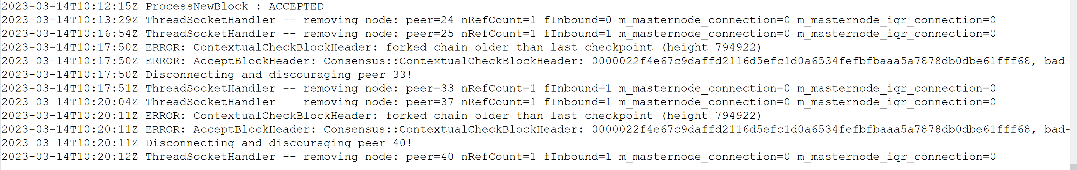

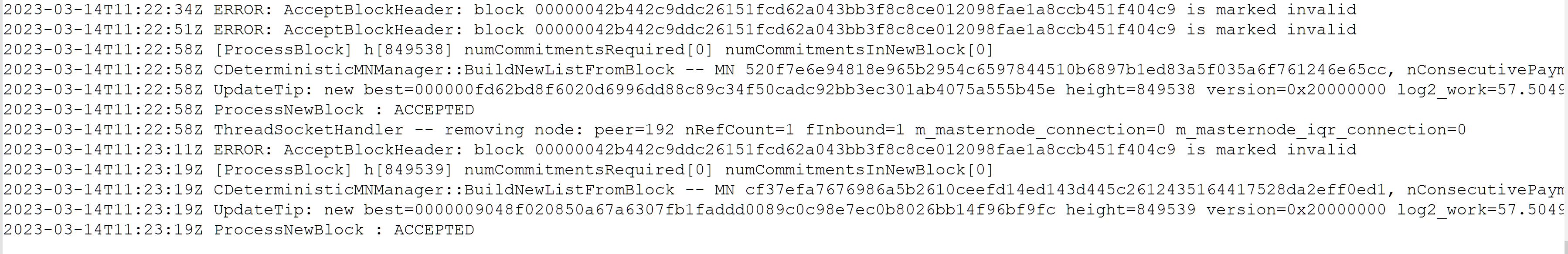

Downloaded from scratch (by deleting testnet3 folder) with v19.0.0 RC6
Noticed some 'forked chain older then last checkpoint height 794922' messages, stopped dashd and did a -reindex, i am now (after the reindex) seeing the following :
FYI (because latest release candidate also involved a malleable BLS fix merge, if i remember correctly --> https://github.com/dashpay/dash/commit/5f26a7b85c33e7d77c363a0bdcdc93681168fc64).
Hopefully this works as intended.
dashd is still busy syncing by the way, its not all invalids (just a lot)

This is the same error I saw on my nodes with RC5 when testnet broke, are you certain you are on the correct binary?
Just did a stop, and restart of dashd and with a new debug.log (saved old 378 MB debug.log in case devs needs it)
2023-03-14T12:07:24Z Dash Core version v19.0.0-rc.6 (release build)
2023-03-14T12:07:24Z InitParameterInteraction: parameter interaction: -externalip set -> setting -discover=0
2023-03-14T12:07:24Z InitParameterInteraction: parameter interaction: additional indexes -> setting -checklevel=4
2023-03-14T12:07:24Z Assuming ancestors of block 00000104cb60a2b5e00a8a4259582756e5bf0dca201c0993c63f0e54971ea91a have valid signatures.
2023-03-14T12:07:24Z Setting nMinimumChainWork=00000000000000000000000000000000000000000000000002d68c04d48c0c9c
2023-03-14T12:07:24Z fDisableGovernance 0
So yes, definetely on the right binary.
2023-03-14T12:10:26Z [ProcessBlock] h[849560] numCommitmentsRequired[0] numCommitmentsInNewBlock[0]
2023-03-14T12:10:26Z CDeterministicMNManager::BuildNewListFromBlock -- MN 0e7917403b2d5cd849bfae417decce7c7c3f05d9322d81ed4ef3a4a753e1f612, nConsecutivePayments=0
2023-03-14T12:10:26Z UpdateTip: new best=0000011304fbdd9fa1496063ce967e92eeb09b33bdf4fb3618ef64061106ff71 height=849560 version=0x20000000 log2_work=57.504916 tx=5795394 date='2023-03-14T12:10:14Z' progress=1.000000 cache=0.1MiB(526txo) evodb_cache=0.0MiB
2023-03-14T12:10:26Z CheckForkWarningConditions: Warning: Found invalid chain at least ~6 blocks longer than our best chain.
Chain state database corruption likely.
2023-03-14T12:10:26Z ProcessNewBlock : ACCEPTED
Will do another -reindex

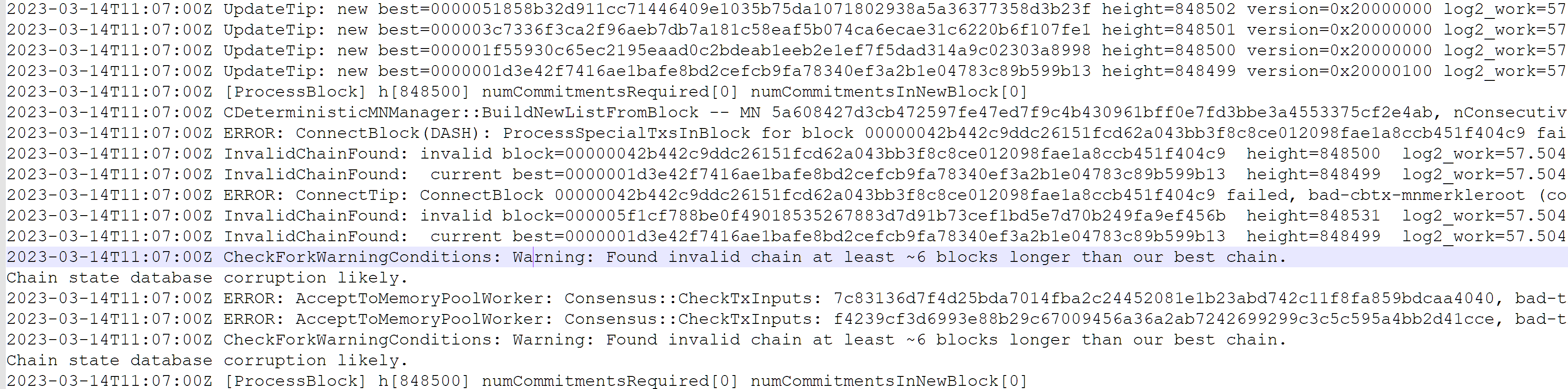

I found this in my old (and rather large) debug.log
InvalidChainFound errors around block 848500 and first popup of CheckForkWarningConditions
I am currently doing a reindex and i am again finding malleable BLS object: iostream error messages and errors about forked chain older than last checkpoint (height 794922), in my new debug.log
So a reindex does not seem to help much. I will try another complete delete of testnet3 folder, restart of dashd and download from scratch.
Edit 1 : Looks good so far, currently on block 849610
Edit 2 : Completely synced up through manual installation methode (through using the binary and just focusing on Core & Sentinel) . I will now test Dashmate setup with v19.0.0 RC6

The "invalid chain at least ~6 blocks longer" isn't concerning as we reorganized the chain. The can be safely ignored.
The "BLS Malleable" thing may be a problem and we are investigating; but at this point we think it isn't an issue

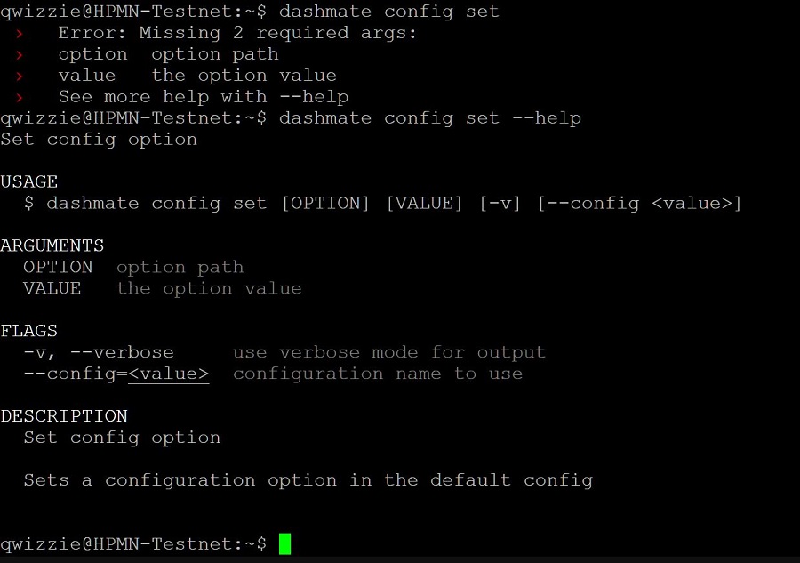

@qwizzie
Assuming strophy's comment at the end was directed towards me : I could use some help here, how would i set dashmate config set command exactly ?
I am not sure what the option path or option value is, with regards to fetching latest Dash Core version 19.0.0 on Testnet.
I know that you already found the way to change version, but strophy meant: "dashmate config set core.docker.image dashpay/dashd:19.0.0-rc.6"

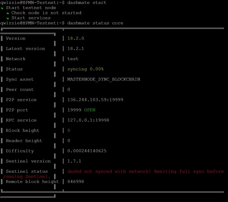

Dashmate has a (layout ?) bug sometimes, where the dashmate status core results are shown improperly in PuTTY :
First try gave improper layout result
Second try worked as intended.
I am on Windows 10, desktop screen resolution 3840x2160 with scale & layout at 225%
PuTTY is in above example in orginal small windowsize. Bug feels related to window size.
Dashmate also sometimes throw a DockerComposeError :
A second dashmate status core try usually works.
FYI
Reactions: pshenmic

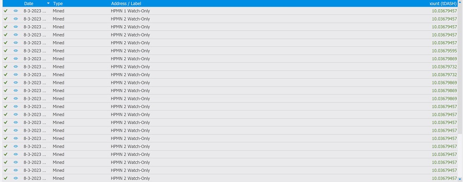

Just received 4x MN payments from my HPMN, so that indeed works as intended on L1 side.
There could be a weakness there, as my hpmn is not connected or in sync with Platform (L2). No hpmn currently is.
This means that hpmn owners could possibly exploit this on Mainnet when v19 gets released there, by choosing / modifying to run hpmn's only on L1,
untill Dash Core v20 activates and they get financially motivated to perform work on L2 as well or they miss out on 75% of their masternode rewards.
Could perhaps even lead to weaker hpmn's being used, untill Dash Core v20 activates.
This is as intended, there won't be any platform release until v20.
