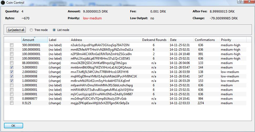

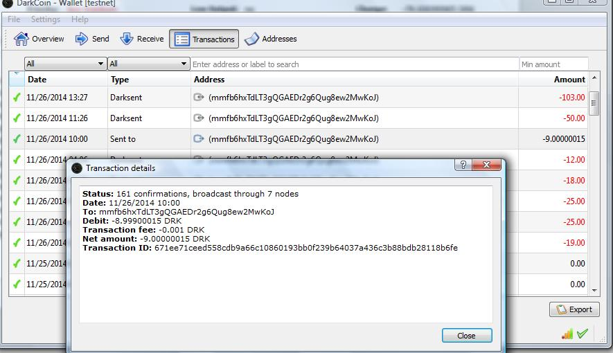

Yes, that's what I would use and have been using all along.
No you haven't, you spent inputs that were not anon. They were inputs that could be linked to earlier transactions. If you're referring to the example you posted earlier that is.
No I wasn't referring to the example. I was talking about using the coin control in spending my real money.
