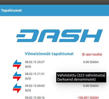

v.0.11.2.17 -> Cosmetic and translation glitches list:
1. Overview tab -> "Try Mix" and "Reset" buttons are NOT disabled when Dash-qt is in the masternode mode.
AjM said:2. Overview tab -> "out of sync" textbox blocks "Recent transactions" text with certain languages, example Finnish.
AjM said:3. Overview tab -> Darksend progress bar -> tooltip is NOT translated.
4. Overview tab -> Darksend Mixing -> "Latest Darksend Message" some messages is NOT translated.
5. Send tab -> Send confirm window -> "Yes" and "Cancel" buttons is NOT translated.
6. Receive tab -> Request payment window -> "Close" button is NOT translated.
I checked 1, and you are right, they are indeed disabled. My bad.They LOOK the same, but they don't start any action...do you get the "Darksend was successfully reset" popup when you click on "Reset"?
Anyway, I've changed it to make things more clear, see https://github.com/darkcoin/darkcoin/pull/296 (commit # 3):
I can not reproduce this, even with the smallest possible wallet-size it looks like this:
Which OS (lemme guess: OSX) and screen-resolution are you using?
