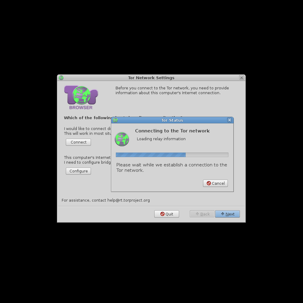

  2. Install the browser bundle, start it and hit connect. You will see a window popping up which shows the status of the Tor connection and it will open the browser as soon as it is connected.

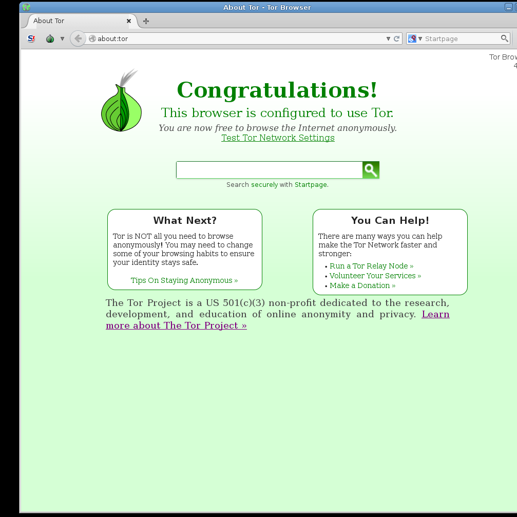

  3. Navigate to http://darkcoinie7ghp67.onion/ with the Tor browser. If you see the website of the Dash relay, your Tor was set up correctly! The Tor browser includes a SOCKS proxy listening on port :9150 which allows you to dip into the deep web. Now we are going to set up Dash.
