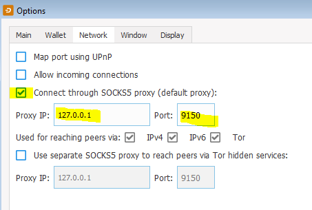

  1. Configure the proxy in the UI.
    In the QT wallet goto Settings -> Options and choose Network. Enable the checkbox for SOCKS5 :eek: Proxy and enter 127.0.0.1 for the IP and 9150 for the port. :)
    Press OK and close the wallet and restart it, it will now connect to TOR and use that to sync the blockchain and send/recieve your transactions. You will need to remember to start the TOR Browser first each time or else the wallet will not sync.
