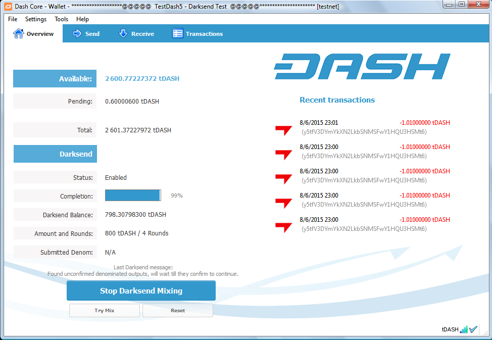

I'm trying to submit another test budget, waiting for 6 confirms atm.
Hmmm.. The wallet i'm using to submit a proposal is being stuck at block 80589.... No wonder my fee transaction would not go through.
Darksend seems working really fast now. I started DS on this wallet about 14 hours ago, got coins through the rounds really fast, but I think the last 7 hours or so all it's been doing is trying to get to 100% which seems impossible for some reason, and because of that it's starting to collect more collaterals. Altogether so far it's got 16 collaterals, not bad, but i'd better shut it down before it will get more?

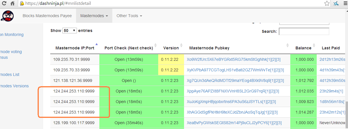

Those 3 nodes are running on your service. Originally I had only 2 running but I just added a 3rd one a few minutes ago
public key: yDDoDLvKberiXXwS1hpX72yL7eD9aYT81Q
I'd like to see multiple MN's on the same IP but different ports
MN01 188.165.84.230:22429 92CcbnGJfcxpXVaVa15fbHKGNu9erCYkUQy6sRUBj6B6RVFacBG 1d8f51be28d510de308e94fb98fcd2a617288a52559fd87a70e19f53a603129a 0
MN02 188.165.84.230:25761 92Lk9xhooCyivT5uJiRh4oTUU4MEZB5NsvK68zCYk2Rb1ucAbyS 1d8f51be28d510de308e94fb98fcd2a617288a52559fd87a70e19f53a603129a 2
MN03 188.165.84.230:28750 93WHhWpdUYXgDyHgQK3dzMtJQq4V4Xswuvgt9DNkL6YEuk2Fnta 1d8f51be28d510de308e94fb98fcd2a617288a52559fd87a70e19f53a603129a 3
MN04 188.165.84.230:19324 91kLfBDDXwPqStVX4RDDx32Hp3VBRT2bkfWuC2mroqNdavARsFJ 1d8f51be28d510de308e94fb98fcd2a617288a52559fd87a70e19f53a603129a 4
MN05 188.165.84.230:26810 91tS1eAAnPw6Atv3hNCv515Bz22bVnG5SuuFz1BeCucuzSS3bNC 1d8f51be28d510de308e94fb98fcd2a617288a52559fd87a70e19f53a603129a 5
MN06 188.165.84.230:17061 929Uu8WfKcrjrY8pccS7xJfPUJpFscEVorCeGe5ABeTAgzNYEz6 1d8f51be28d510de308e94fb98fcd2a617288a52559fd87a70e19f53a603129a 6
MN07 188.165.84.230:12747 91njQwjerh9quACm6qe7dsLrSUGAF2WcqnZTvdTbjiZ4ffVr3gv 1d8f51be28d510de308e94fb98fcd2a617288a52559fd87a70e19f53a603129a 7
MN08 188.165.84.230:21781 93U8EyhXhuR2rXCAgLWpmdB8EZovGEKCRQwp7HgVKswqM8s5Jms 1d8f51be28d510de308e94fb98fcd2a617288a52559fd87a70e19f53a603129a 8
MN09 188.165.84.230:26304 92DXejNvunJ8x8GV9Qfwxkz5cDMXJ8KUZ4GT7KF1vbKMeHisvB3 1d8f51be28d510de308e94fb98fcd2a617288a52559fd87a70e19f53a603129a 9

On Main net - lol - ya goof :-P
edit: It would make my Pi life so much eaiser
I fired some cpu mining wallets back up in case that helps. And ds mixing.
okay - well - I guess
When I think of people like Otho - it makes more sense
so - I'm done asking for that - lol
moving on :-P
edit: hummm - I wonder if it would work with a free dynamic DNS service - just thinking at this point :-P
