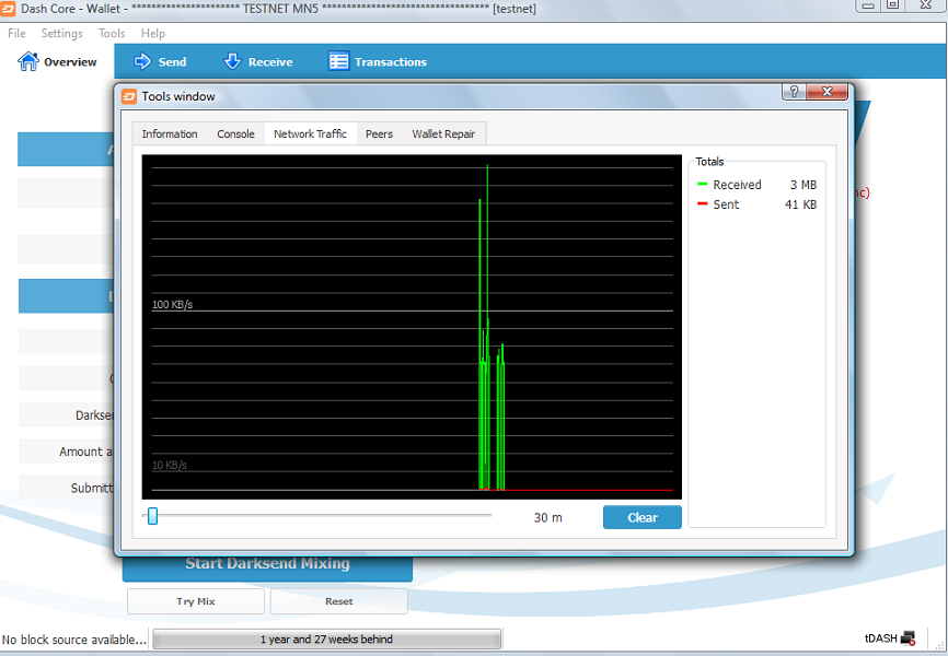

One of the wallets I used to test v12 keeps getting stuck at block 75799... I've tried to run it with -reindex twice.

Now I have another wallet that was created for v11, got synced fine earlier but now it's stuck at block 78031 (0 hours behind).
EDIT: eduffield - now it's ok... lol

That wallet would not sync at all. I also tried it with a new fresh wallet but still it would not sync one block.
EDIT: Build 249 solves this problem: https://dashpay.atlassian.net/builds/browse/DASHW-DEV-249/artifact/JOB1/gitian-win-dash-dist/

Oh shit, the one node, the one on my windows machine, that I thought was running fine all this time, stopped syncing at 78097. It acts as if it's finished syncing so it must have gotten hooked on an earlier fork. Hummm.
I really want to get 11.2.23 up and running on testnet before switching. But if everyone has already switched to 12.35, then I may not be able to sync, eh?
Evan released 35 so I got it running Qt is all
stuck at 19 hours
edit: reboot Qt - not stuck now
78098
Yah, but I really wanted to sync up the old 11.2.23 and test the upgrade, but I was gone all day yesterday and apparently even my windows testnet wallet never sync'd so I have nothing to try upgrading with. I'm hoping I can still get 11.2.23 to sync so I can upgrade and see if it works smoothly. Ugh!
