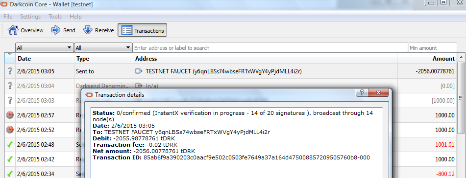

Another larger IX (no DS) transaction:
In what case does it get 0/confirmed?
"InstantX verification in process" means the network is looking at the transaction and waiting for signatures in order to lock the inputs. These transactions will always say 0/unconfirmed until the threshold of signatures is met, which is 15 currently.
"Verified via InstantX" means it gathered at least 15 signatures and has locked the transaction. It means it's safe and block-level/transaction-level locks are in place to protect the money from being double spent.
After five minutes if enough signatures aren't collected you'll see "InstantX verification failed", which means the transaction will fall back on proof-of-work validation.
