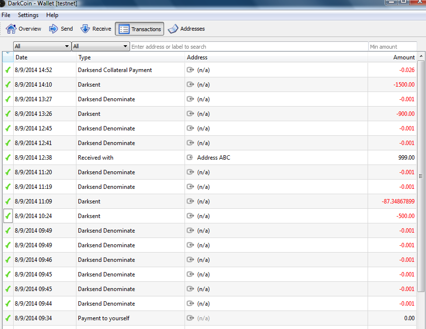

Win wallet v.18... I started a fresh wallet with 0 drk. Got 3000 tdrk from the faucet. Then got 6 denominates, I guess 2 for each 1000 tdrk. Here's what my wallet looks like after some spending and receiving tdrk. Also, got one collateral fee. And the coin control screen shows (7 locked). Hope someone can look at this and see if this is normal:

I got a collateral payment earlier on. But i figured out why.
I would send a payment and leave the computer for about 30mins so it can go through the process. Once i return the computer is sleeping, i move the mouse and there you go, a collateral payment appears.
This maybe your problem.

Hm... You're probably right, but who would keep staring at the wallet screen the whole time... Also, there will be internet interruptions and computer crashing during transactions in the real world so I hope collateral fees will be taken into consideration in these situations.

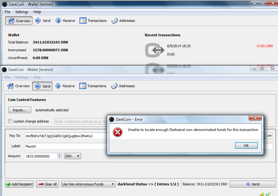

I'm posting another screen that I don't understand. My wallet has enough to send 1833 tdrk using "Non-anonymous funds" but it says otherwise. And the coin control screens says (18 locked). Not sure if it's going to anonymize more coins? The anonymization sometimes takes very slow to happen.
Some of the 1800 you are trying to send are probably locked because they have begun the DS+ process, as shown in the darksend status thingy, and are waiting for compatible pool entries.

OK.. Now a DS denominate just popped up, coin control screen showed (18 locked) and now 970.99900013 DRK unconfirmed. SO, yes DS was waiting for entries to anonymize these coins like you said.
But it shouldn't have said "Idle" the next minute though.
On a rare occasion when DS Status said "Idle", I was able to send 20 tdrk using the Non-Anonymous Funds. But most of the time when the status says "Idle" it still won't let you use the available non-denominated funds, nor will it let you use it as anonymous funds either. The wallet seems to be seeking to anonymize almost all of the amount of money but it keeps taking breaks in between and takes a long time.
