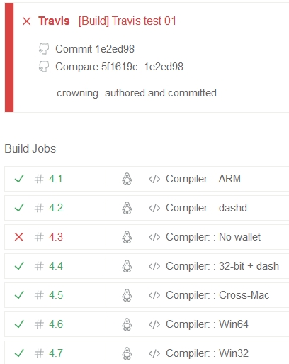

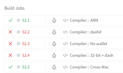

I have at least enabled Travis building --> https://travis-ci.org/dashpay/dash
But we need to have a look at some failing tests :)
Thanks.
I guess ".travis.yml" needs some love. If I'd find some time next weekend I'll have a look.
Edit: yep, log says the tests are run which fail for Dash of course. The individual builds overwrite RUN_TESTS=false. Should be an easy fix. I'll do it later today.

Almost there:
I'll have another look later (or tomorrow) for the one failing build and create pull-requests once it's ready to merge.

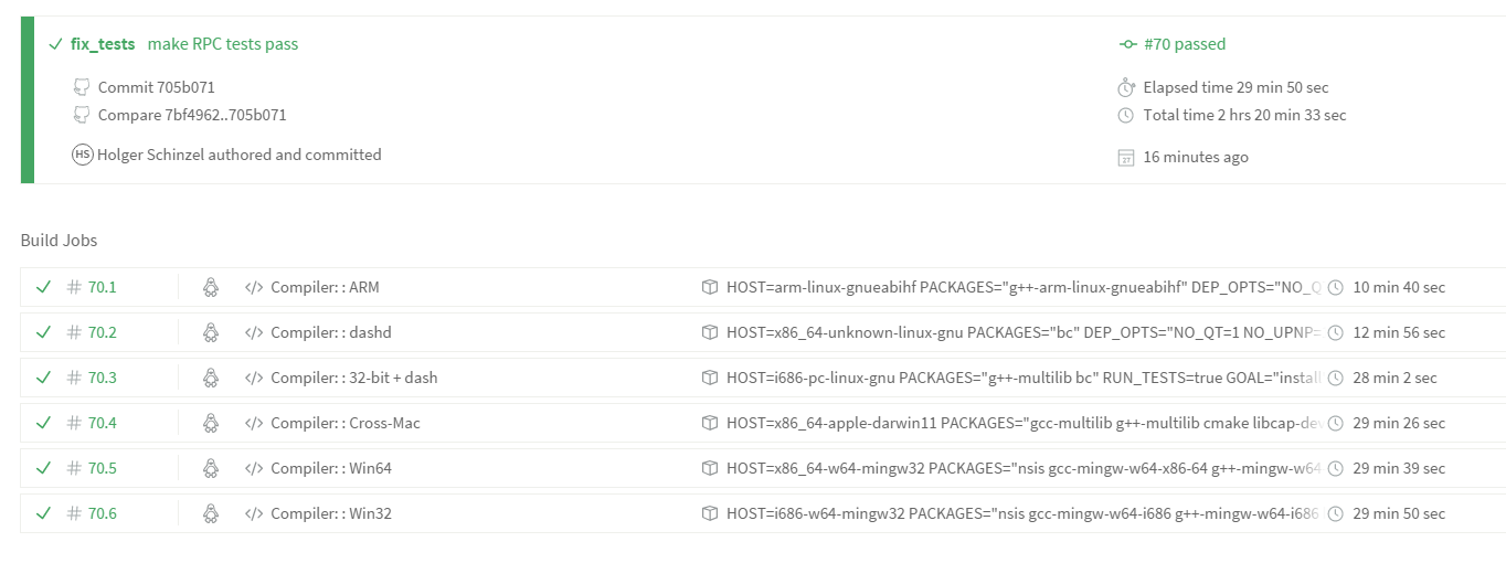

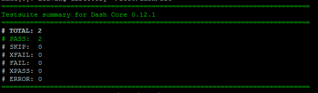

I have found the root cause for the wget problems: wget on precise (which we are using on Travis) is outdated and not able to connect to SSLv3 enabled sites.
I have worked around this by using curl (see https://github.com/travis-ci/travis-ci/issues/5156)
So at least the testless ARM and MacOSX builds are green now, and I have made good progress on the failing tests for the other platforms - only 245 failing tests to go :)
We are getting there :)

if [ -n "$OSX_SDK" -a -f depends/sdk-sources/MacOSX${OSX_SDK}.sdk.tar.gz ]; then tar -C depends/SDKs -xf depends/sdk-sources/MacOSX${OSX_SDK}.sdk.tar.gz; fi
tar: This does not look like a tar archive
I can't access https://dash.org/depends-sources/sdks, so I don't know what's in there.
The path structure did not change, so https://dash.org/depends-sources/sdks/MacOSX10.7.sdk.tar.gz works
edit:
Down to 234 failures :)
https://travis-ci.org/dashpay/dash/jobs/105368611#L4806

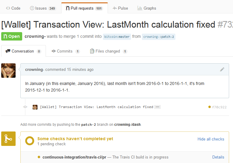

Is Travis better than GitHub? Will you be using this now instead of GitHub?
Travis is an addition to GitHub, no replacement. You just have to assign a GitHub repository in Travis, and whenever new code is committed into your repository Travis automatically builds and tests it so you can easily see when something is broken without having to build it yourself all the time.
Saves us developers a ton of time.
